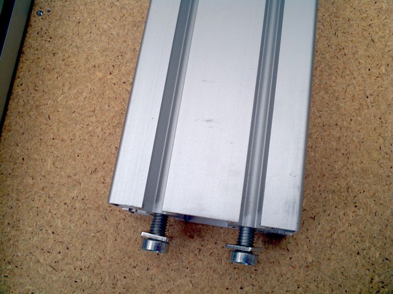

Herewith the first dry assemble of the frame.
This is only rough to ensure the fabricator sent all the right parts.
Looks OK so far, one minor quibble with the alignment holes at one end but overall very happy with what they did. Cost with freight from Sydney was just over $1k. That may sound high but remember this extrusion goes for over $200 per length and I got them to do all the drilling and tapping plus supply fixings.
Anyhow, off to the hardware store this morning to gather bits for making a proper table, then move onto the full assembly.
