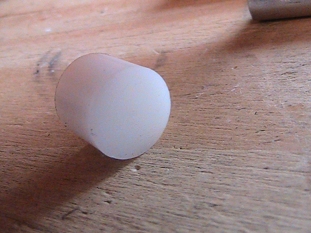

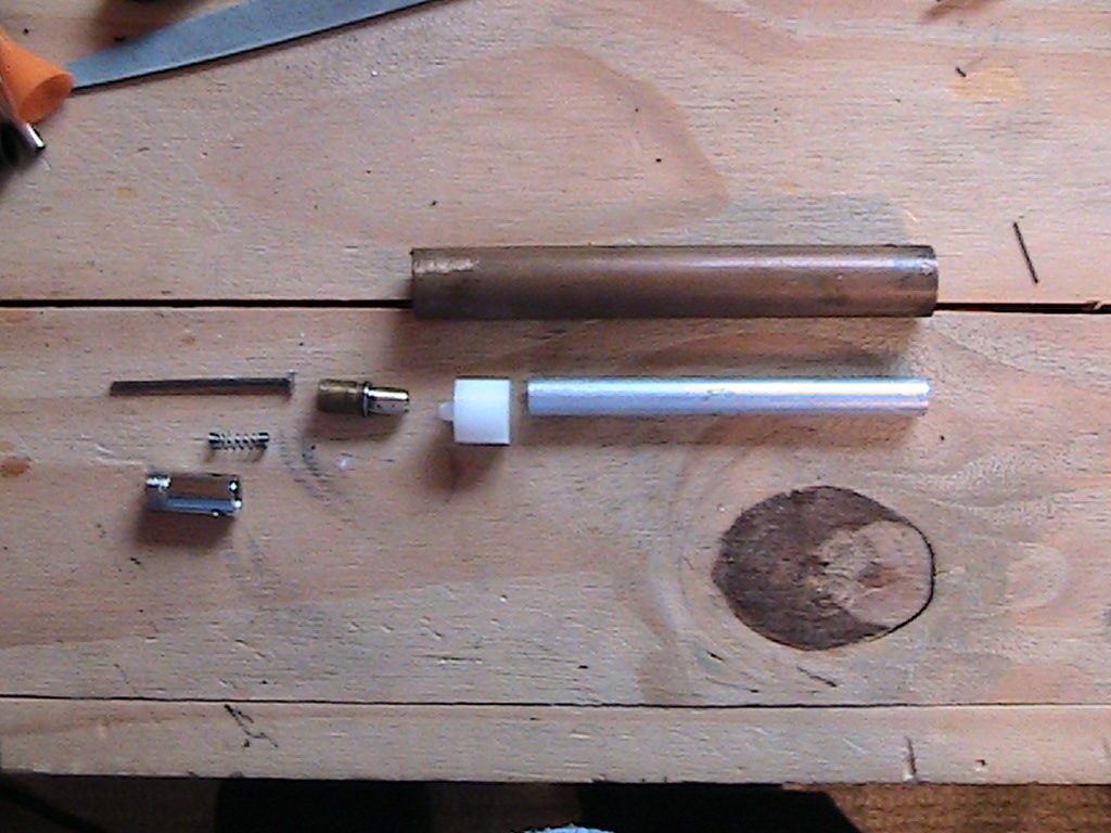

i havent made a mini in a very long time and i want to get into pen guns so i thought id start with a prototype.
main tube 1/2 inch copper.
caliber 6mm
piston machined nylon
valve schrader
pressure 250psi
it works pretty well and sends bbs flying rather nicely. i used jsr's method of using a drill bit to keep the barrel centered while the epoxy cured. i hope to make a few brass pen guns with lighter machined nylon pistons
thanks
piston
piston

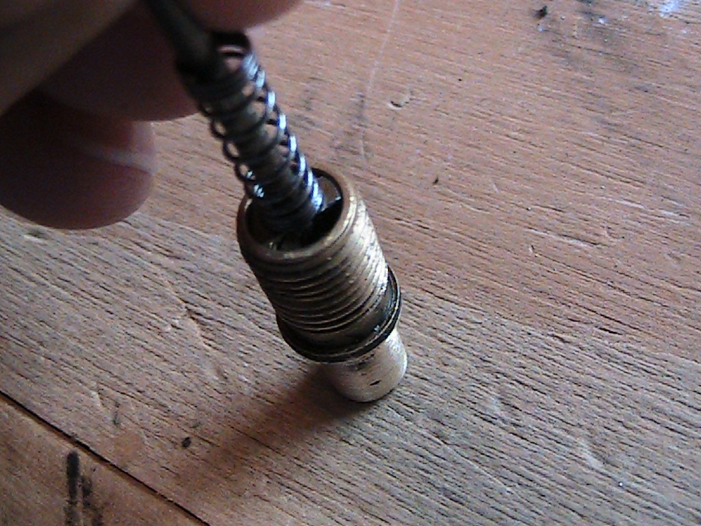

with spring and in valve

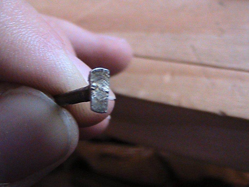

nail head for trigger
before epoxy and trigger mechanism<br />note that the little &amp;quot;tail&amp;quot; on the back of the piston was cut off and the back was hollowed out with a drill
note that the little &quot;tail&quot; on the back of the piston was cut off and the back was hollowed out with a drill

jackssmirkingrevenge wrote:Not a bad effort, did you put any rubber seals on the piston or is it just nylon against metal?
its just the nylon and is leak free as i smoothed out the back of the barrel for a perfect fit.
