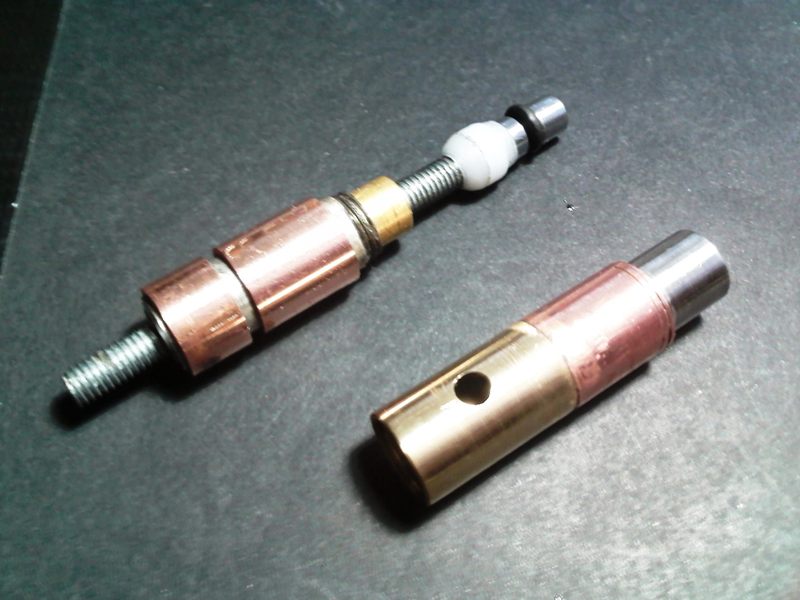

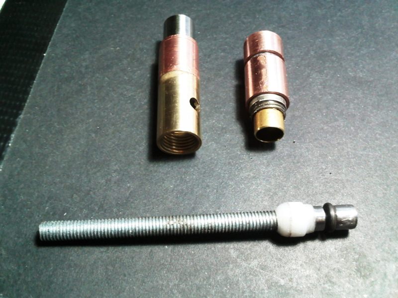

OK, I almost finished my counter balanced hammer valve :roll: (still need to make a cap, or maybe I will see if it allows blowback semi... Also need to drill the output port)
Full metal except the seal(nylon).
Haven´t try it out yet, also I have made a bad choice: use floating o-ring on the counter piston :cry: Now I don´t know if t will seal...
Pictures, if any of you see any problem, please tell me before something goes wrong :)
Netherlands
Posts: 3497
Apart from sealing problems..
how far can the valvestem move?
Looks like the nylon seal is in the way..
hard to tell from a picture..
The O-ring should be floating.
It should rest against the inner walls of the pipe it runs in and on the front shoulder of the groove,
wyz2285
Austria
Posts: 2390
Location: Porto, Portugal
It does fit very well inside the tube, should not have leaks. Didn´t understand the "on the front shoulder of the groove" part.
The valvestem moves about 0.5 cm. Good flow, the nylon isn´t on the way.
