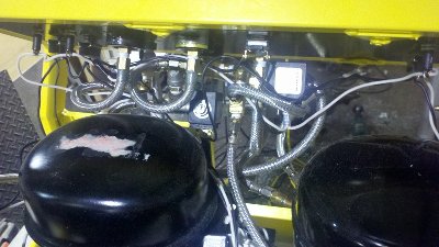

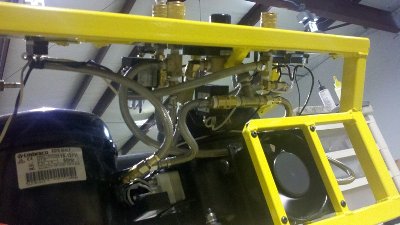

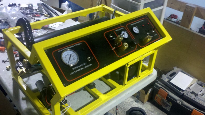

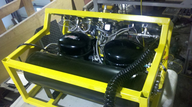

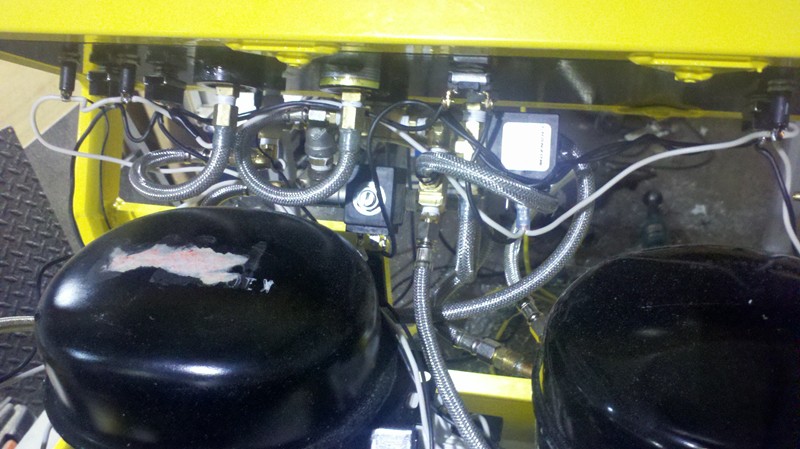

Here are some pics.
The top cover is not on. But, other than that, it is totally finished.
Matt

Any pictures of the compressor(s) with the top cover?
My cannons | My QEV cannon |
I will get some pictures with the cover on soon. I need to cut two holes in it for lines to pass through before I mount it.
