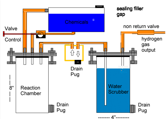

This is a H2 Reactor prototype by RJB
It produces H2 gas, it is clean in a WS (Water Scrubber), there is an Overflow chamber to avoid the water from scrubber inside the main reactor.
There are safety valves and uni-directional valves.
At moment I have done a small experiment to have more experience before begin all the project.
The chemical is, in this case, HCL, the reactor has already the Al.

- Closely you can see a manual safety valve to avoid an increase of pressure.
- Prototype by RJB.png (26.68 KiB) Viewed 8332 times

The secure chamber, that is what is between the reactor and Water Scrubber, contains an electrical sensor to detect water on...

I'm sure you've considered this, but some gaseous HCl will probably be evolved. This will be removed by the water scrubber but be careful having any exposed metal before the water scrubber.
Pure copper is fine for the connections/chamber etc. as HCl will not react with it. Brass is ok, while the zinc near the surface will react, this will halt after only copper is left at the surface exposed to the HCl (won't take long).
I'd reduce the volume of air above the water scrubber. While the risk of ignition is low, it's still a factor worth considering. It will also result in less air being pumped into the chamber. On the same subject, while a small risk, I don't consider a non return valve to be effective at stopping a flashback, and a flame arrester will work better. However if the volume above the scrubber is reduced then flashback isn't a problem and the non return valve will be fine.
Finally, be cautious if you use a plastic container, as the reaction can evolve a fair bit of heat.
Good luck! Good work it seems so far though

Thanks Major, I am using PVC to conections and glass to the reactor. The scrubber is smaller than in the project, but tell me more details if you remember...

I have done it already..... it reaches 4Bar
