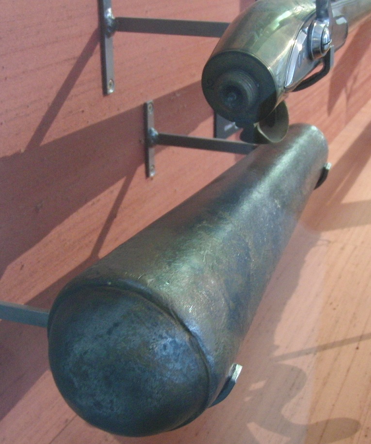

I recently had the pleasure of feasting my eyes on some genuine Girandoni air rifles while in Vienna, herewith some photos:

Looks like I got my work cut out for me...
what is this part?
Doesn't look original and...where are the threads for the buttflask?
what is this part?
- Has thanked: 581 times
I actually asked about this, the best information I got was that it was a tool used during valve servicing.Brian the brain wrote:what is this part?
