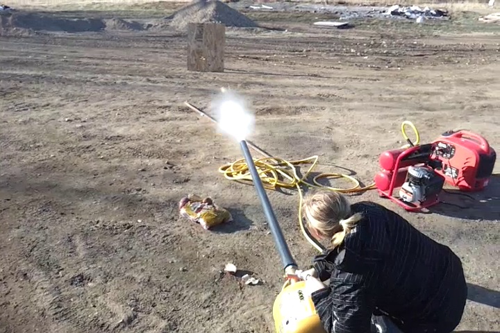

I just made a spud gun (cannon) it was a bead seater. Now it is a cannon! it has a 75" long barrel 2" diameter made with schedule 80 ipex with a 2" butterfly valve and it packs a punch. The chamber is 12" in diameter and 12" long. I am new to this form so I hope this works and you like the spud gun. This one was easy to make and a blast to shoot!

spud just leaving the barrel
spud being fired out of cannon family get together

Not bad, if you want better peformance you should try putting a burst disk between valve and barrel to compensate for the butterfly valve's relatively slow opening time.
Ryan00101101
Posts: 4
Joined: Tue Apr 24, 2012 10:42 pm
Burst disk would be the ultimate valve where do you get them though? Like to break at 120psi would be sweet.
All you need is a union to hold it, maybe something like this.
I also find that camlok fittings work well too.
