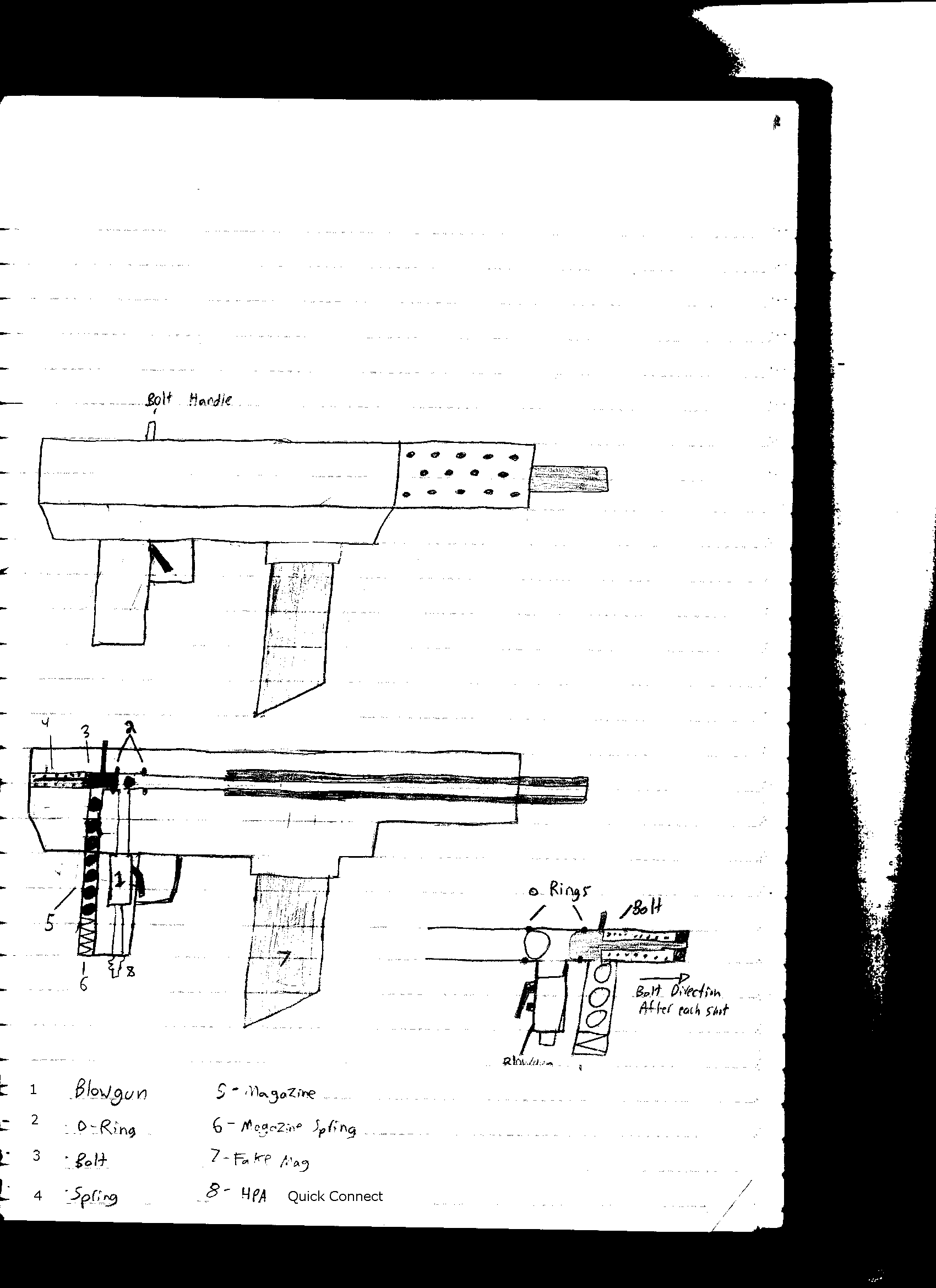

The gun is supposed to work in full auto but i figured that making it work will be a challenge
Blowbackwards Bolt?

Here is a concept that i was dreaming up in math class a few months back. Please give me some feedback, thanks

It Probably won't cycle in Full auto, semi is Possible but it may need some tweaking, Most likely scenario is that it jams.

I figure that the back o-ring has to be weaker then the front one because the back has the spring force too, and because you need them both to blow at the same millisecond to cycle properly.
The beauty of this is that you can use a needle valve and make the flow small for a smaller rof, without sacrificing power

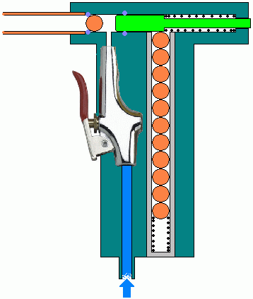

- its based of this in JSR's insanely cool cartridge fed gun thread

It should work but you will need HPA, I gave this a go with compressor pressures and there wasn't enough force to overcome the o-ring friction.

so we are talking about like 450 psi, and how would i be able to change the spring force if adjustments are needed

450 psi should be enough. as to an adjustable spring, you can either have a threaded endcap, or one with multiple holes that would allow you to insert a holding pin at various stages to adjust travel and tension.sagthegreat wrote:so we are talking about like 450 psi, and how would i be able to change the spring force if adjustments are needed

Now im wondering if anyone has even attempted this mechanism or have any tips on construction?

Have a read through this thread: http://www.spudfiles.com/forums/blowbac ... 21985.html

JSR, you said you tried it, did it have any significant power?

Enough to punch through a soup tin but not incredible, but then again unless you're using HPA any small calibre launcher is going to be marginal.sagthegreat wrote:JSR, you said you tried it, did it have any significant power?

Do u happen to have a video, some motivation would be helpful, cuz mine wont work

There are some target videos in the valveless cartridge thread
