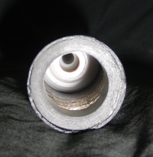

Here's a massive one I made for one of these in 9mm:

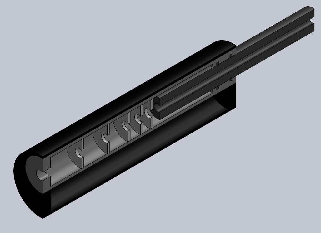

I made it similar to the Shinsung suppressors, but it slips over the existing shroud instead of being threaded and the first baffle area is perforated to allow air to expand into a large 70mm (around 2.75") diameter tube I slipped over. The eccentric design allows a large area without interfering with the scope line of sight.
3D rendering is the original idea, a little different from what I actually made.

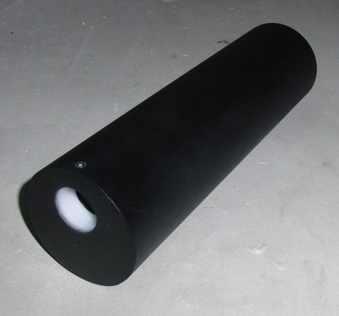

Yes indeed :) even if I say so myself. Wasn't happy with the endcap finish so I refinished them, now it's looking great. I ordered some black delrin so that for future models I can avoid painting altogether.

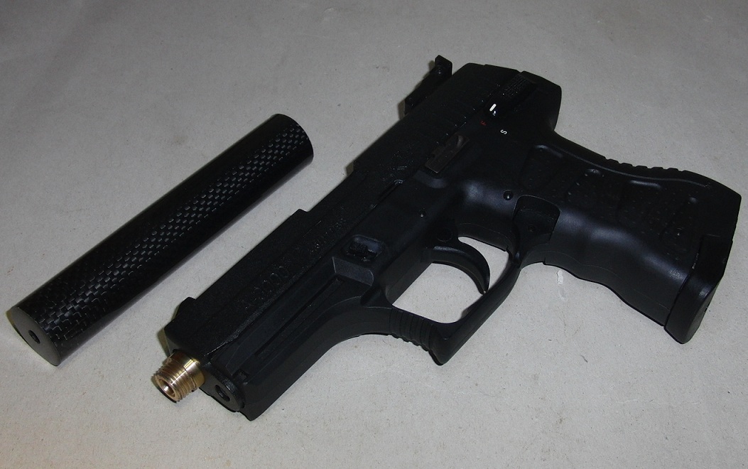

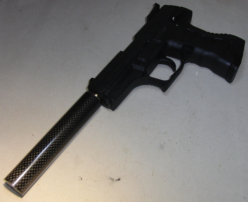

Some of you might remember the rather primitive suppressor I had made for my Anics A3000 "Skif" CO<sub>2</sub> pistol using lego blocks as baffle separators:
I decided to revisit the idea taking advantage of my improved fabrication facilities, herewith the result. Chopped off part of the plastic barrel sheath and epoxied on a brass sheath with a male 1/2" NF20 thread on the end, then made a 5" long 1" dia carbon fibre suppressor to fit, much smarter now :)
