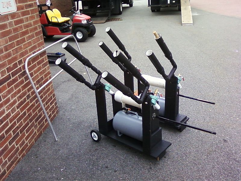

I built these 2 air cannons as props for the high school marching band that 2 of my kids play in. The concept of the show this year is medieval knights, castles, etc. So the idea of flaming arrows shot from the "castle" came about. The idea is to shoot 2 arrows from each side of the field at the start of the show, and 2 arrows from each side at the end of the show. The launchers and one person to fire them hides behind large panels on the field that serve as the castles.
The supply tank is charged to about 100 PSI, and the regulator fills the upper chamber to about 50-60 PSI. This pressure can shoot two 2" dog-toy tennis balls with the plastic bag "fire" about halfway across the football field and go about 40 feet in the air. We can get about 4 or 5 shots before the supply tank needs recharging.
The valves are modified Orbit 1" sprinkler valves with ball valves to make them fast enough for this purpose.

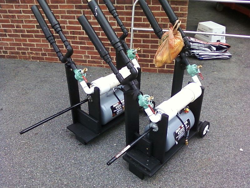

Supply tank, regulator and upper chamber of launcher.

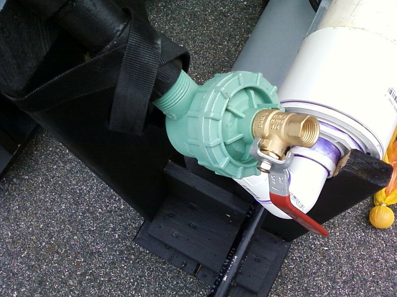

1" orbit sprinkler valve modified into QEV.
