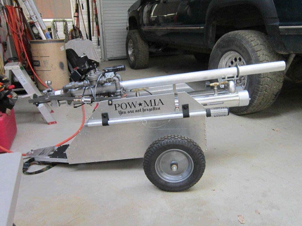

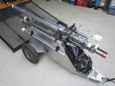

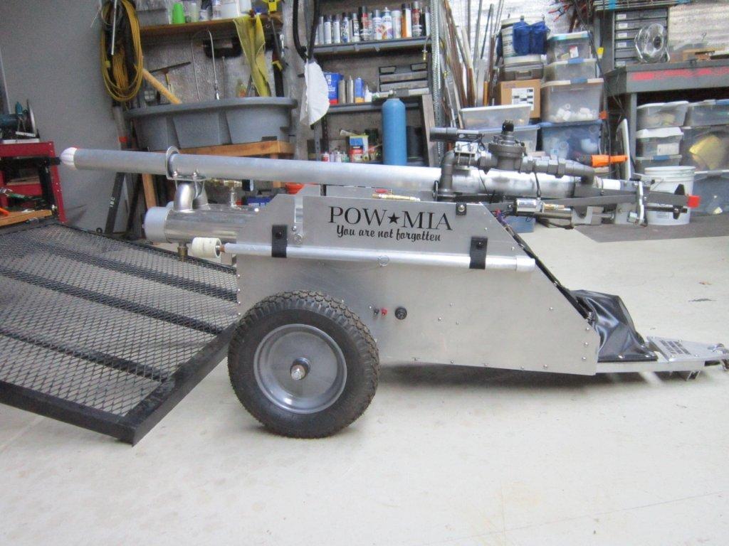

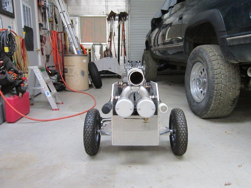

Hello everyone- I have been viewing potato cannons for quite some time now and have just joined this forum as I have something to share. I've been building for years from scratch everything from black powder arms to this pnuematic all stainless steel, aluminum, breech loading potato sizing/lemon cannon. Lemons are now the preferred load as they are attaining 2000 ft. and will blow the bark completly off of a full grown oak tree! The cannon has a onboard air compressor, 12 v battery and connection for outside air source which is preferred for repetitive shooting, the loading bolt is actuated by air and manual valves, elevation is changed by air from the video sighting/fire control unit. I have tried but have been unable to load pics, internet can't display web page, will try again, in the mean time here is the YOU TUBE ADDRESS, search You Tube video for hhhh 0001 two hands cannon. Thanks and enjoy, 2hands

On your next one, make the flow path shorter and larger between the chambers and barrel. Try to completely vent the chamber into the barrel in under 30 ms. Hissing out air long after the projectile is gone indicates too much flow restriction.
