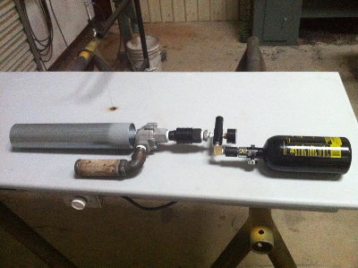

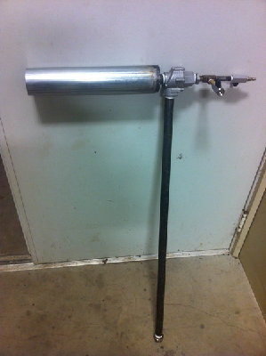

Cobbled up a few parts and did a couple of tests. Can shoot a 220gm t-shirt 80 ft at ~160psi. The pressure chamber is a 3'x3/4" piece of pipe (what I had lying around the shop). The barrel is 2 1/2" EMT x 14" long.
The only thing I've manufactured so far is the barrel. I turned a plug from a 1/8" thick piece of plate on the lathe and welded in a 3/4 metal pipe threaded on one end - screws right into the QEV.
My son and I played with it for quite some time. Now I see the addiction of spud guns. :lol:
Next items to be tested:
Palmer Reg set to 300psi with 48ci HPA
3/4 QEV
Smaller pressure chamber
garybdavis
Posts: 31
Joined: Sun Nov 04, 2012 2:45 pm

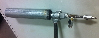

Got my slide valve and Palmer regulator in. The silder really made a difference in the piloting of the QEV. At 200psi, I'm shooting 120ft or so with a nice arc. I'm not completely happy with the layout, so I may remote mount the tank with a hose.
The barrel is 14"x2 1/2 EMT with a custom welded mount. The pressure chamber is one I welded up just for testing. It's 1.375 ID by 5" long. I'll buy a new piece of pipe for the final version once I'm satisfied with the results. I'm thinking about making two different pressure chambers for it. one that is about this size and good for shooting around 200psi. And one that's about double the volume for shooting longer distances at the same pressure.
A few tweaking questions for you guys:
The 3/4" slider is big so it has a great feel to it (easy to get your and around it). Would a 1/4" slider be more or less efficient?
The slider will leak sometimes if you are using it well above 250psi mark if you don't slide it hard to the fill position. This slider is rated for 250psi and seems well made. Is that normal?
I think I can get around 20 to 30 shots per 48cu in tank. This at 200psi with around 8 to 9 cu in pressure chamber. At 300psi, it seems to be more like 15 shots, but obviously the shirts fly farther. I looking for the sweet spot between efficiency and component reliability. I know the higher pressure I run at the more stress it puts on the QEV. Is it really more efficient to run at a higher pressure and smaller pressure chamber or is 8 to 9 cu in at 200 to 250psi about right? I'm getting enough distance to make me happy.
Last question, does anyone see anything terribly unsafe about the configuration?
Thanks

Looking good!
Currently looks like something you would use to lob t-shirts at zombies :D
Video of it in action?
garybdavis wrote:I'm thinking about making two different pressure chambers for it. one that is about this size and good for shooting around 200psi. And one that's about double the volume for shooting longer distances at the same pressure.
Why not keep the same chamber and tweak the pressure?
It depends on the porting, generally moar porting = better piloting = moar power.
However if you have a smaller pilot volume using the smaller slider, this would offset smaller port area.
Inspect the o-rings for wear, especially look at the porting to make sure the edges have been properly bevelled. A bit of lube (something that the o-rings won't absorb) goes a long way to keep wear down.
Instead of looking for higher pressures, it might be worth looking into your projectile - packing makes a big difference, you might want to consider for example packing the t-shirt into a large paper cup in the barrel.
I don't like the elbow which attaches the tank to the reg. It's unsupported and potentially can have a lot of stress put on it, I would consider an external structure that doesn't make it bear all the load. Otherwise, looks great!

Yes, the 1/8NPT connections to/from the regulator make for a weak physical connection point. It's good enough for some testing, but not for continuous use. I'm thinking about ordering one of their regulator mounts and a braided hose. When I do that, I'll remove the elbow between the tank and regulator and use a close nipple instead. Only problem is what to mount the regulator to. I suppose I need to create some type of a handle or stock for the whole thing.
Any home welded pressure tanks (the elbow and chamber) should be hydrostatic tested. If you later want greater range, look for a slightly larger valve and chamber. I launch t shirts 200 feet at 100 PSI with a home built 1 inch valve. This put shirts into the stands from cross the field.

Technician1002 wrote:Any home welded pressure tanks (the elbow and chamber) should be hydrostatic tested.
I assume any of the places that test scuba tanks will test my home made pressure chamber? What pressure do you have them test it to (I plan on running 300psi max)? The other two I can see are to use threaded pipe and fittings, a small scuba tank like a spare air. or maybe a small CO2 tank that are rated/stamped from the manufacture.
I'm trying to keep the pressure chamber small and run at 200 to 300 psi to keep the overall air consumption down. I guess I need to do the math to verify that's true. In other words, which would give me more shots per 3000psi 48cu in tank; large pressure chamber at 100psi or smaller pressure chamber at 300psi?
garybdavis wrote:I assume any of the places that test scuba tanks will test my home made pressure chamber? What pressure do you have them test it to (I plan on running 300psi max)?
I doubt they would be willing to do that... but surely you could do it yourself, fill it with water or oil and get pumping to 1.5 times your planned operating pressure.
