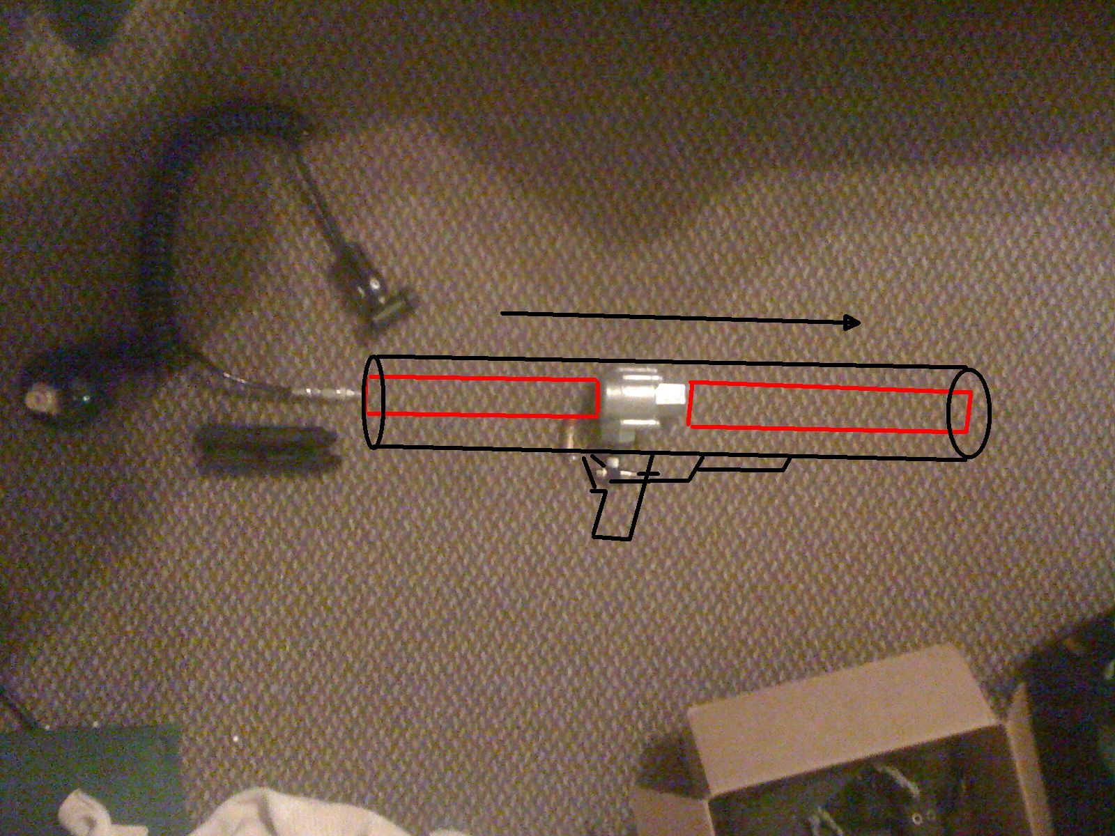

My first air cannon. Going to be used to shoot nerf balls :]
Jarrado
Posts: 22
Joined: Thu Nov 15, 2012 12:14 am
So far I have the following in the picture to work with. A QEV4 I picked up, a co2 charger that has a co2 regulator I can use till I get a palmer, a remote line, 20oz tank, 4 co2 12g adapters.
Im trying to keep it all inline for aesthetics and want as loud a "pop" as I can get without spending much more, with the exception of the palmer. Which, if someone has a palmer for a tank they would sell, I'd appreciate it.
Im going to be working on about 80-90psi and will install a 125 psi blow valve in my steel expansion tank behind the barrel. I think I'll be using regular galvanized steel. Probly 2''x12'' long. plus adapters. Then a 18'' pvc barrel fitted for nerf rounds.
Im trying to source a decent 3 way valve that wont come from china /: that isnt super expensive. Havent had much luck. But do I really need one to vent the QEV? I want it to have a "trigger" mech, so ball valves are out, but since Im using the QEV as my main valve, I figured that anything else would pilot too slow.
I'll also use this during large airsoft skirmishes as an anti tank weapon. So I plan on wrapping it in up and painting it to look like an AT4 or maybe a swiss gustav.
I understand enough to know which way the air flow is in relation to my QEV. Air>ball valve>Expansion chamber>QEV (3way,pilot)>barrel>exit. Gotta start somewhere though. haha.
The 12g's are for simple straight line launchers.... just gonna slap spring loaded ball valves on em. I'll fab them myself. Pull, lock, spring open.
I'll also be making two different sized barrels. 40mm~ and 52mm~ or whatever is closest to my ammo Im using. Still have to go check. I'll be using pressure rated pvc sch 40. Maybe sch80 if I can source any.
Pictures of the parts I have so far, I'll post up as I go along.

Ok. Got my parts in. Now just to figure out what the final length will be, get fitting, etc. I realize I have the QEV backwards in the photo, I'll have the exhaust side facing the proper direction when I go get fittings.
Couple of questions:
Can I simply drill and tap the 2" expansion chamber and screw in a safety blow valve? Or do I need to use some kinda tee fitting? I do machining, so making a proper threaded hole is peach easy.
Im looking into making this a breech loader, but how would accuracy be impacted if the ammo is loaded breech or end loaded not being pushed down with a ram rod?
And ratio. Should I just make a 2" chamber 16" long for a 16" barrel? I keep reading conflicting opinions all over the web. I would really NOT want to take this apart after its done. I also read that some people use as much as a 2:1 chamber/barrel ratio. 0_0
Im looking to keep the actual PSI as low as possible, since I want my rocket ammo to stay intact for as many shots as I can.
Lockednloaded
Posts: 1566
Location: Texas, USA
Sorry, but you have that QEV setup completely wrong in your sketch. You have your barrel hooked up to the port for the pilot, you have your pilot hooked up to the port for the chamber, and you have your chamber hooked up to the port for the barrel

Yea. I did note that in my post. I just tossed it down for a quick picture.
And I thought the EXH side was the side that needs to hook to the barrel?
