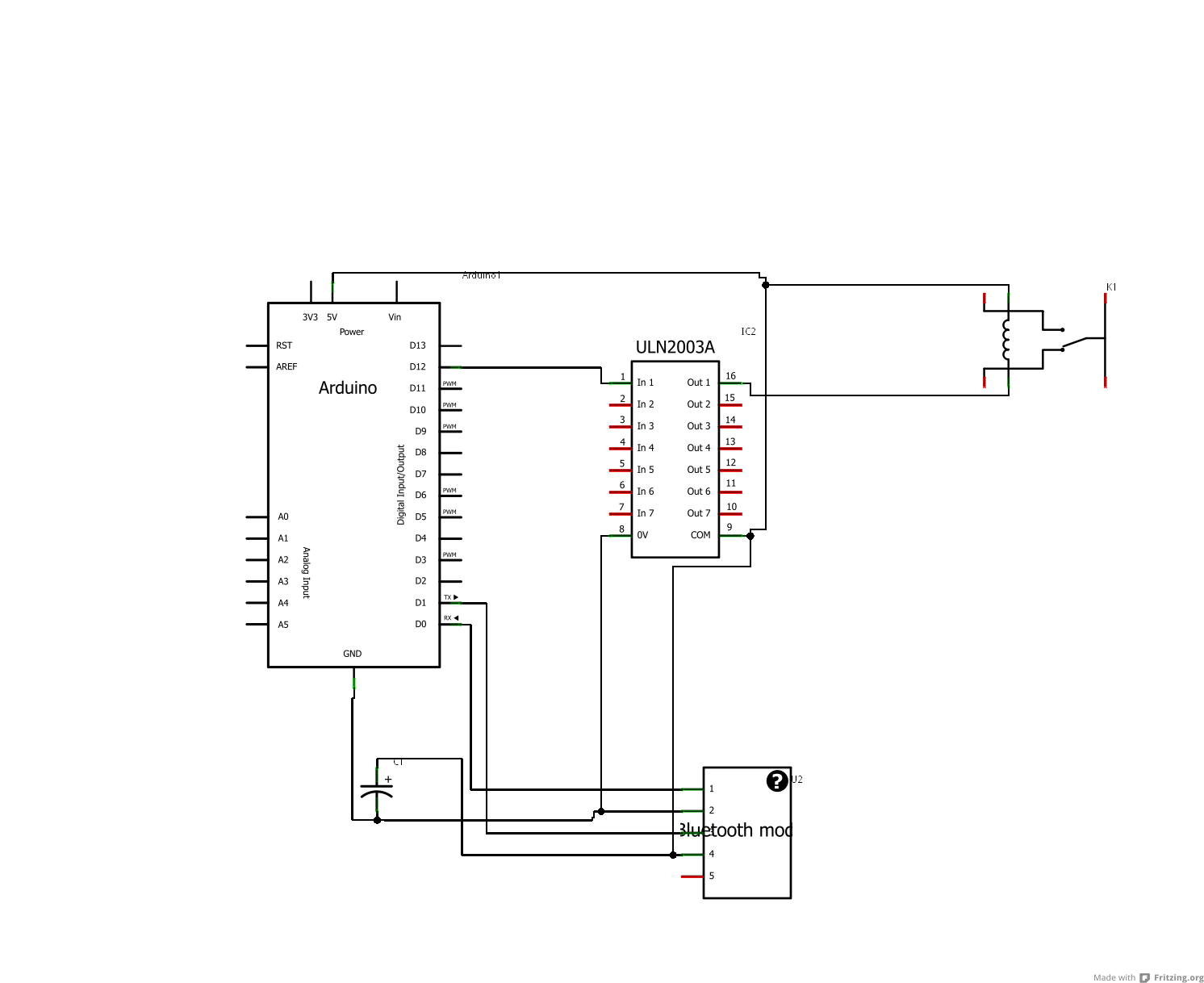

here is a diagram of the circuit (notice that there is a decoupling cap I had to add after I notice that the arduino freezed a couple of times due to high EMF from the ignitor)
EDIT no3
Realized that the original code and schematic had a serious design flaw - arduino bootloader flashes the LED on the board on power up - since the LED is connected to PIN13 it meant that the circuit would switch the relay for a fraction of second on power up.
Fixed both the schematic and the code - now it's PIN12

anyway I attached the circuit to the relay so that all of you could see that it really really works (ULN 2004 is used to drive the relay)

That can't happen
Though I've just realised there is a serious design flaw -> On arduino boards the LED and PIN 13 flashes on power up...
so in other words - once you power it up and you've got the ignitor connected to the battery the gun will fire
I already changed the code and schematic

I think you should add a "safety" interlock switch in series with your switched ignition power also.
