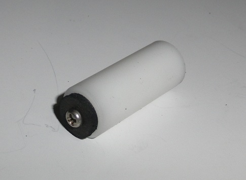

Here you go ;)
Jack, I might employ your services soon. I'll get a sketch together.
Will be away from my tools for February so if you need something urgent let me know asap.

jackssmirkingrevenge wrote:Here you go ;)
If that's mine, looks really good! I'll PM you my address.
