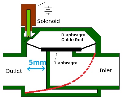

In one of my valves, I measured the diameter of the chamber inlet and it was only 22mm (the seat is 26mm). This distance between the wall of the seat and the 'outlet' was a mere 5mm. Also, as shown in the diagram below, the bottom of the valve is not flat (as depicted by the red line); there isn't much room at all for the air to spill over the top and out the porting. The sweeping bottom may even be more severe than depicted, the red line is just a rough guess. Granted, the air doesn't really need the volume at the back of the valve as it is trying to get out the front.

Is this for a coaxial valve? If so, a tee valve wouldn't have the same limitations if the seat is in the middle of the tee. In fact, wouldn't a tee valve almost be analogous to the sprinkler valve in the sense that the 5mm gap between the seat and outlet is equivalent to the gap between the bottom port of a tee and the seat, which, if the seat is placed in the middle, would be 25mm in a 50mm tee. That's a lot better than two valves with gaps of 5mm.
Yeah, I was thinking in terms of coaxial.
One look at all the acrobatics the air has to go through to pass through a sprinkler valve should be enough to convince anyone to go burst disk.
