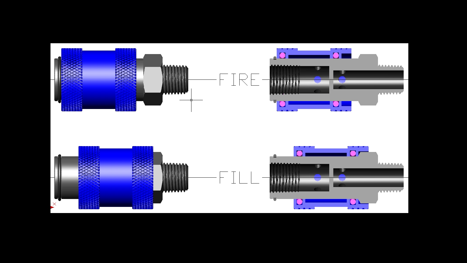

I updated the slide valve to show O-rings.
I had to "guesstimate" the locations and size!
That's a good guestimate, nice one
