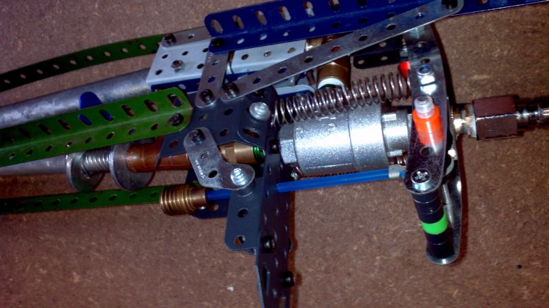

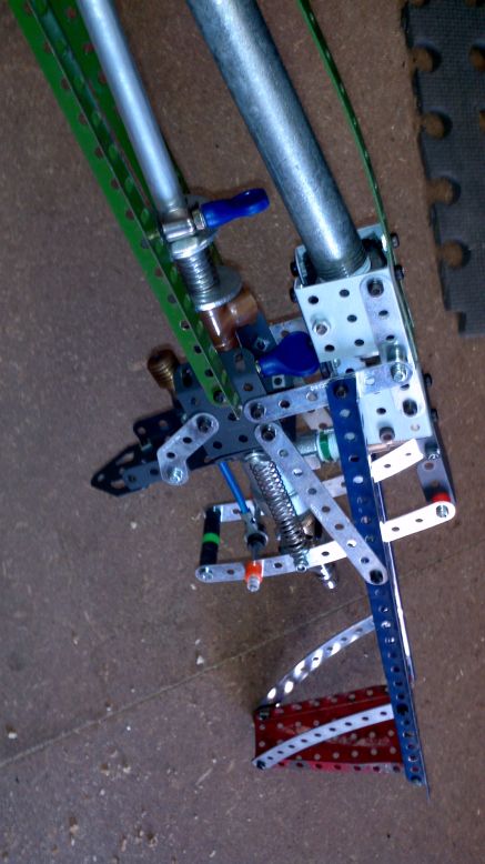

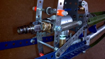

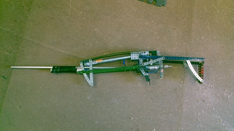

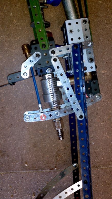

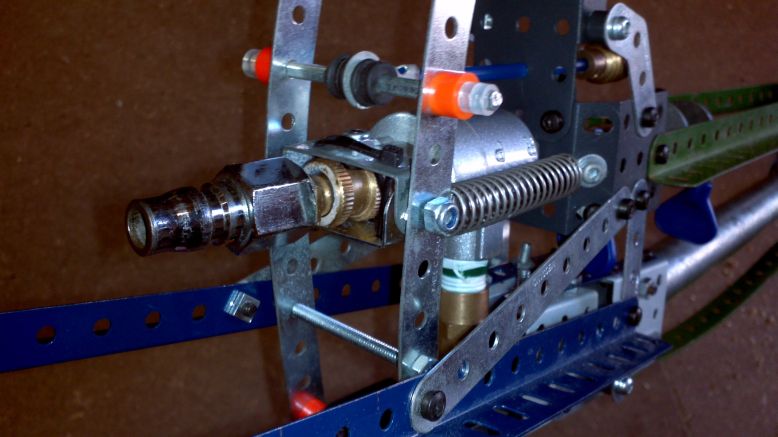

In a post-Apocalypse world when all you have left is $20 of plumbing fittings and some Meccano, what do you do to hold off the zombie hordes............
You build this for fun. An afternoon plinker for the kids.
  • 100psi on the compressor
    10mm plastic BB's
    Some tube from Bunnings (Home Depot for the rest of you)
    My 40 year old Meccano set
    Single shot breech loaded
To do is a tube mag, some sort of sights, flash suppressor, muzzle brake, bipod...................
Video maybe tomorrow
Edit:Added rear photo
Thanks to JSR for the idea and the tutorial on a cheapo QEV setup :D
