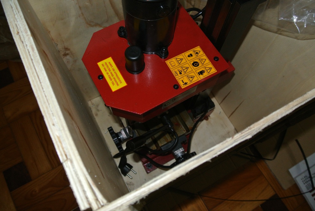

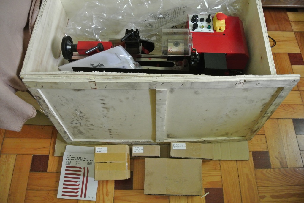

Finally I got the boxes open :roll:
40kg each, still haven't figured out how to move them into my work shop.
BTW it came with more accessories than I thought :D
PUI btw lol :roll:

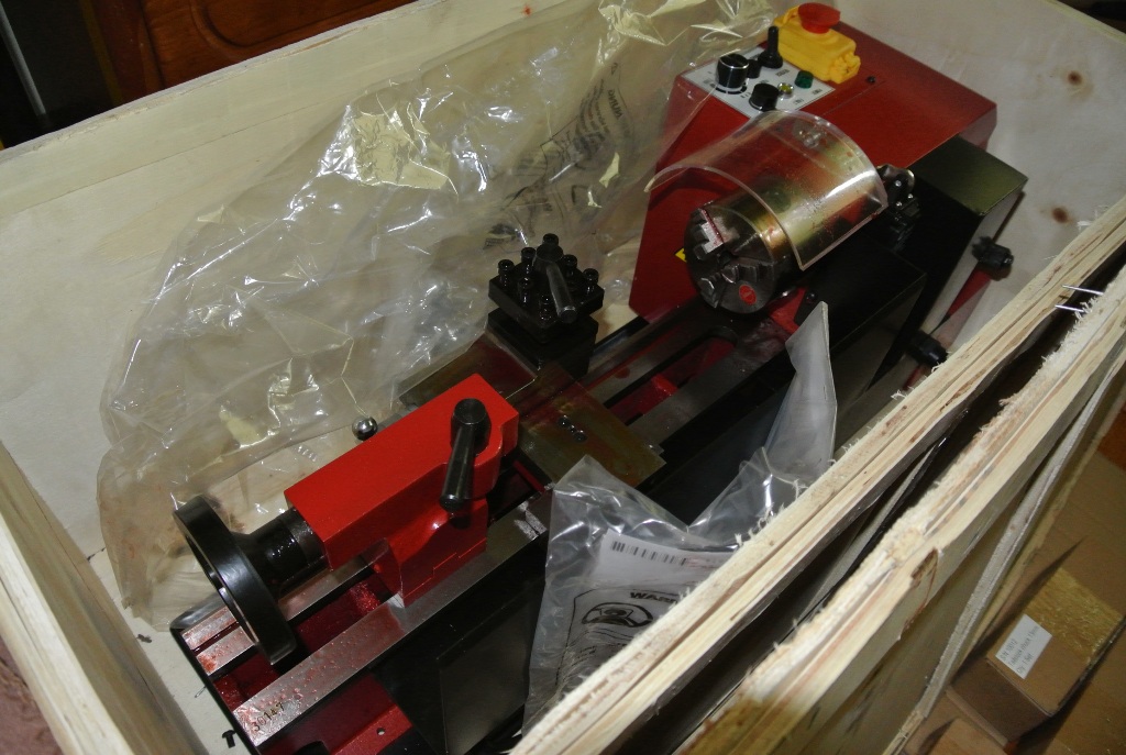

The instruction book is very helpful, has almost anything for a beginner.
Would I be in trouble if I don't secure it on a bench with screws? I don't want to drill on my table and it's dead heavy so I think it's fine...
