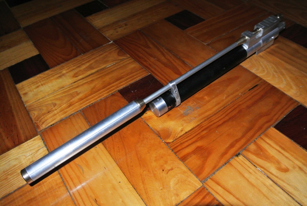

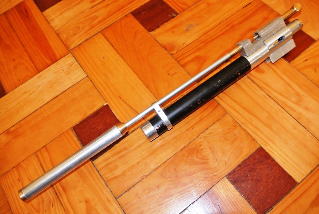

Almost done
will finish the trigger tomorrow.
Also will make a proper thread when finished. Please be nice it's the first time I make a PCP

Looking great, you are puttig that machinery to some good use

Not really
lack of planing now clearly give me headaches...
However, I learnt some precious experience with this so the next one I'm going to make will be much better
Can't wait for the rotating table to arrive

There's that learning thing again L0L.wyz2285 wrote:Not reallylack of planing now clearly give me headaches...
Looking very good. General advice to everyone, if you're really into making stuff and have a couple thousand dollars to spend, get yourself a lathe and mill - it is easy to teach yourself, and with a bit of dedication the tools will soon pay for themselves.
