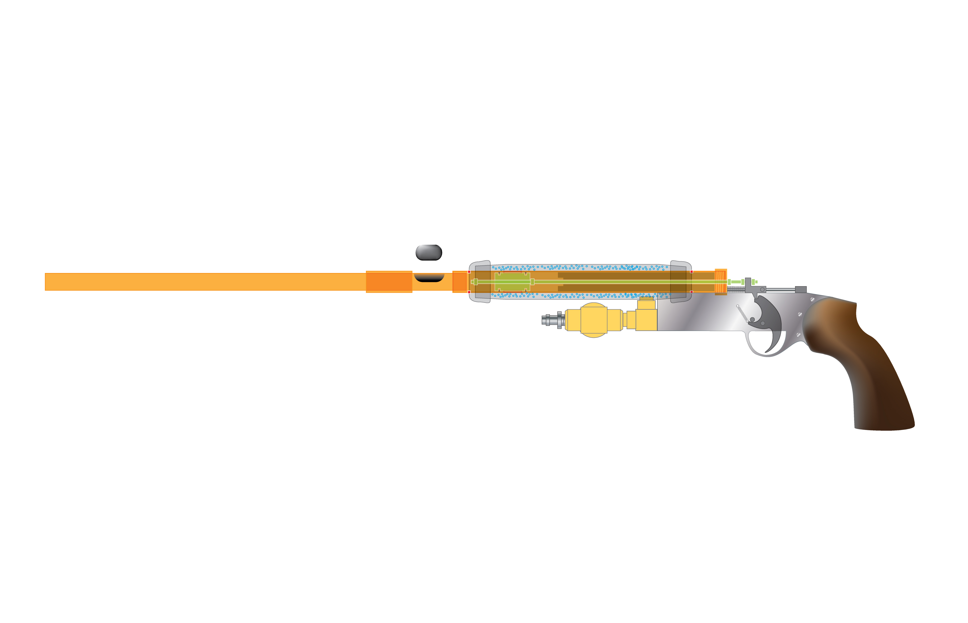

Here's a pengun design I had imagined using such a valve:

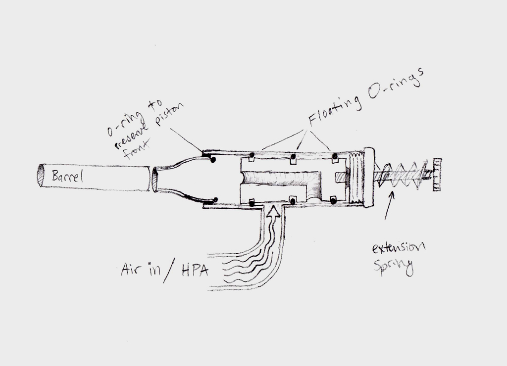

ok, I'm thinking about this idea for the piston now...
(1) For the piston, I already have this nice fitting pvc tube rated to 160psi, could 300-400 psi crack this pvc's wall (when in closed position) from the pressure trying to get out below?
(2) Instead of a hammer slamming the piston over, I'm thinking of using an extension spring that will be held back by a trigger mech. Thoughts, links?
(3) I'm not sure how to calculate an ideal chamber/barrel ratio. The air chamber at the moment is a 6" long, 1" diameter steel pipe and the barrel will be 1/2" copper. The pressure will be 300 to 400. Thoughts on how long the copper barrel should be?
Thanks!
Thanks!
Pipes are typically much stronger in compression.air_dannon wrote:(1) For the piston, I already have this nice fitting pvc tube rated to 160psi, could 300-400 psi crack this pvc's wall (when in closed position) from the pressure trying to get out below?
The way its configured, pressure will try and reclose the piston... you might want to follow the more "conventional" QDV configuration.(2) Instead of a hammer slamming the piston over, I'm thinking of using an extension spring that will be held back by a trigger mech. Thoughts, links?
GGDT is your friend(3) I'm not sure how to calculate an ideal chamber/barrel ratio. The air chamber at the moment is a 6" long, 1" diameter steel pipe and the barrel will be 1/2" copper. The pressure will be 300 to 400. Thoughts on how long the copper barrel should be?

Watched Technician's video some more and think I see where you were going with more conventional... instead of pushing the piston forward: (1.) chop that unnecessary back section off my piston, keep it solid, float the o-rings (2.) make a mech to pull the piston back just enough to let the pressure slam it back against a bumper.
Pretty much... also, since you will be pulling the piston as opposed to pushing it, the design and fabrication of a trigger system is made easier.

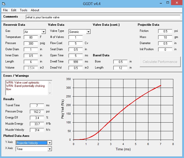

Based on Technician's QDV I have designed this idea for a sawed-off look. The chamber is a 1" x 6" steel nipple, and the piston sleeve, running through the center of the steel, is a 1/2" copper repair coupling. The sleeve will have two "vents" cut on opposite sides of the piston to equalize the pressure on the piston.
I've played around with the GGDT, but I'm not understanding many of the needed variables it asks for... I'm not even sure what type of piston Technicians would be in the drop-down?
My main question is with the chamber to barrel ratio in the design. With that copper coupling running through the middle of air chamber, it cuts that chamber volume from 1 inch to 1/2 inch essentially, correct? So, a ratio of 2:1 would mean the chamber is really 1/2" x 6", so a 1/2" copper barrel would need to be 12"?

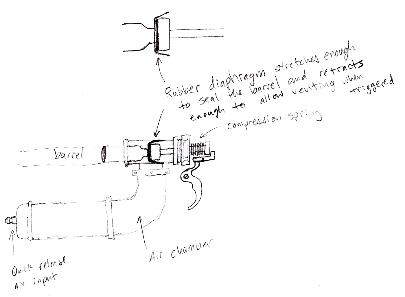

The first thing that annoyed me was your trigger geometry ;P
The way you drew it, pulling the trigger means you have to first push the piston slightly forward against the firing spring, meaning it will be hard to open.
Fantastic rendering otherwise

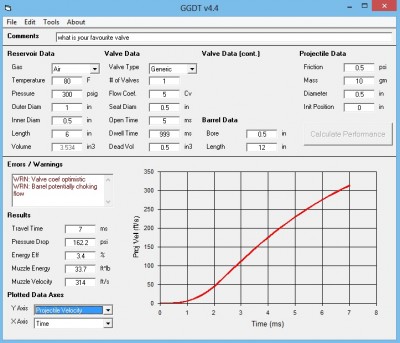

With regards to GGDT, I took the liberty of modelling the valve for you. I used the generic valve setting, with a maximum dwell time (as the valve won't reclose) and an estimated opening time of 5 milliseconds.
This is a piloted piston valve opening filmed at 1000 frames per second:
It takes about 15 milliseconds to fully open. As QDVs effectively have zero piloting time, 5 ms is a good estimate.
I used 300 psi and a 10 gram projectile.
With regards to chamber volume and barrel length, plug the values into GGDT and play with the variables, see how a longer chamber or barrel affects performance until you get something you're happy with.
Just my two Canadian cents, if you want real power for less hassle, go hybrid

Good point, I need to add a sear (I know what a sear is now... progress) to that trigger system. Thanks for all the info, JSR.
