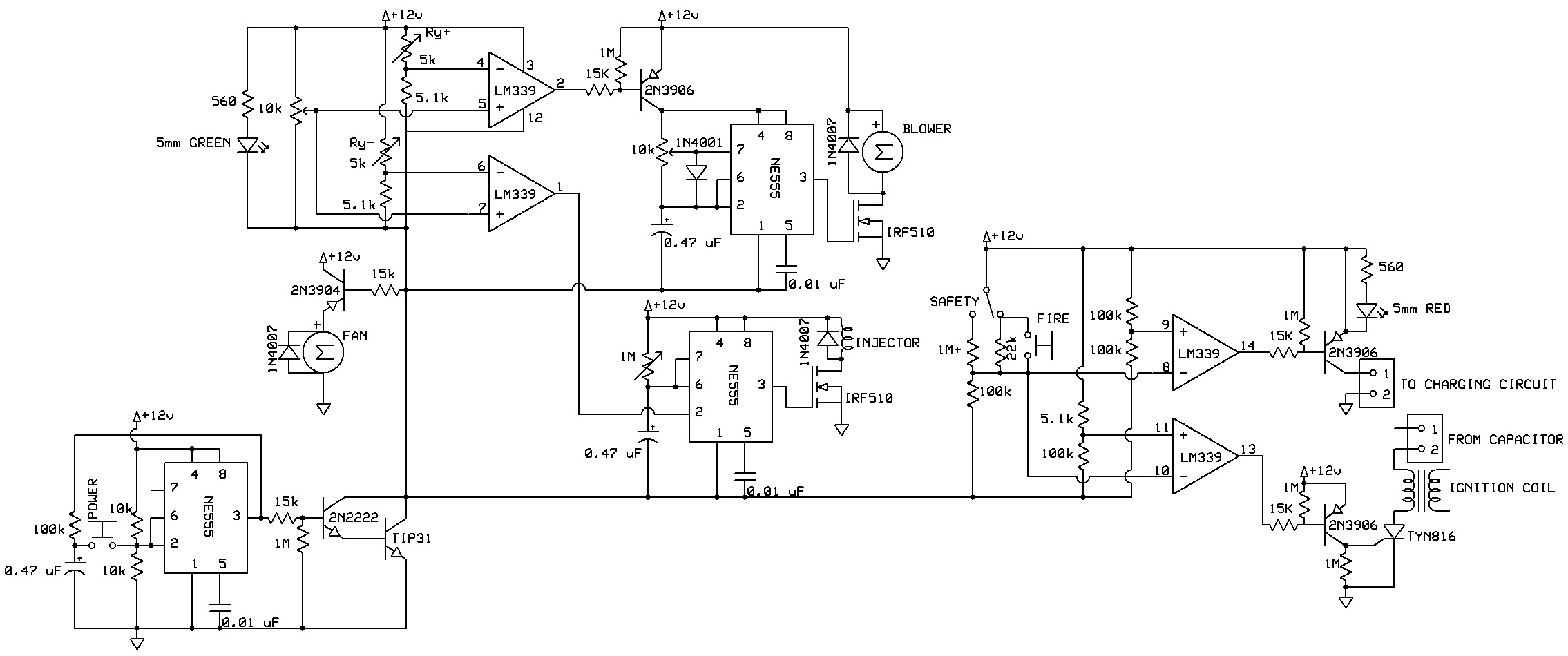

Prepare for POLAND_SPUD's face to melt off.
Prototyped most of the "blocks" already. Finished product and cannon incoming.

I've highlighted the source of most of the added complexity... I'd say it's worth it. I bought a DPDT switch as a backup, though. :lol:

And very nice mark. May I ask why you didn't choose to go with a micro controller? But it's very cool that you're willing to design you're own analog circuit when there are lazy fecks like me around :lol:

I am with pneumaticcannons on this - Why didn't you use a uController ?

POLAND_SPUD wrote:I am with pneumaticcannons on this - Why didn't you use a uController ?
It's just what I like to do. I still have an arduino micro I could use, but I enjoy fooling around with analog circuits.

Ah, OK. Certainly the best way to ignite very high mixes without a beefy high-voltage igniter.
