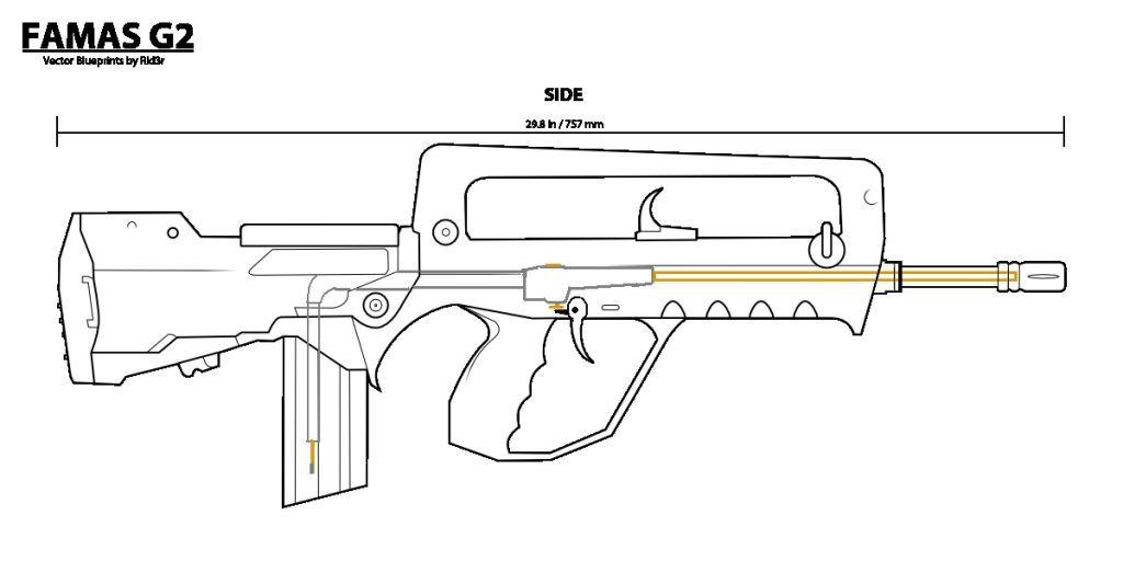

if this is your blowgun you can make a trigger system like this
and then put the blowgun into another body of a gun, i used a FamasG2 in the pic but it can be a pistol or any rifle you want
i can't accomplish my dream of making a M82A2 design pneumatic gun because i cant make the M82A2 body :( but i think a body of FamasG2 can be made out of wood to put your blowgun inside making your pneumatic look realistic

Talk that is an interesting idea, however I was thinking for some of my other pneumatics I was maybe going to make wooden grips/stocks for them, as I don't have any airsoft gun bodies I'm able to use right now, but I have lots of planks taking up space.
