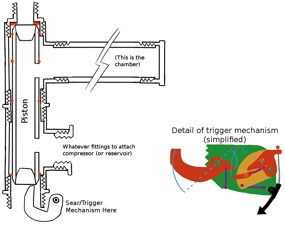

I'm back from finally assembling the valves. Wanted to have that done before replying here. That and also, I made a sketch to better explain how I've implemented the concept of GB semi's HEAR Valve. I hope these drawings aren't too large:
This up here is a simplified (for clear understanding) version of my HEAR valve. Along with the mechanism that engages and disengages the Sear (or "finger" as I mentioned before). That sear detail drawing is colour coded in respect to what collides with what. I'm thinking about using acrylic plates to make that mechanism. The green back has a threading so that it attaches to the valve in a convenient way. The black thing with an arrow is the bicycle cable which attaches to the trigger at the grip. As you may have guessed, we can use leverage in these mechanisms and therefore, pressure against the trigger finger is a non-issue.
The mechanism is designed to allow semi-automatic fire by being sort of a ratchet where the pawl forces the sear (a one tooth gear) to rotate and then it slips out of the tooth's range, therefore re-engaging the sear. The axis of rotation of the lever which carries the pawl can be adjusted so that the pawl never lets off the sear, and so enabling auto-fire. The purple lines are rubberbands or springs.
This up here is how it cycles each shot, and so answering JSR's question on how to make it full auto. I admit that the O-ring (orange dots) positioning wasn't well thought out. I was hoping that it wouldn't need much of O-rings, but after testing, this valve failed.

Fascinating, yet one thing appears odd - if the piston is of constant diameter, whither the pressure imbalance that would encourage it to move once the sear is released?

I'll try to make it clear...
You have to bear in mind that the side of the valve with the sear is open to the outside air. The opposite end is an exhaust to the Bolt (hopefully also at atmospheric pressure).
Most of the time, the piston will tend to move out of the valve. But, at stage 2 of the cycle diagram, it will be stopped by the sear and stick while the chamber pressure is higher than the atmospheric pressure. At this point air can't flow to the chamber from reservoir and the chamber is evacuating, so the piston acts as a membrane or something that follows the side with least pressure. When Chamber pressure is equal to atmospheric pressure, and because of the sear, the piston will shoot back into the valve, causing the exhaust port be closed and the path from the reservoir to the chamber to be opened.
At least that's the theory. :?
I wonder what Bryce "clide" Bell would think of this... :wink:

I don't know... In the test I made, it indeed moved as expected (partially; although it didn't return into the valve), but then it was an improperly built piston so I can't comment on the concept itself. I suppose that (given that it works) when blocked, a piston will behave as if there was infinite pressure on the blocked end. Actually is just an hunch and this explanation doesn't sound right to me. That's why we test things out!
Edit: On second thought, I'd say that maybe the narrowing caused by the exhaust port could make this difference in pressure momentarily...? Maybe I'll end up to have to throw in some springs :P .
Dig_Gil wrote:On second thought, I'd say that maybe the narrowing caused by the exhaust port could make this difference in pressure momentarily...? Maybe I'll end up to have to throw in some springs :P
This looks like it could have helped, because physics says your design shouldn't work and had you made it with o-rings I'm fairly certain it would have remained resolutely static.

Another point worth mentioning is the fact that the exhaust port will be connected to the Bolt which is a piston where a spring will make it unavoidable that the pressure in it will be slightly higher than that of the outside.
Dig_Gil wrote:Another point worth mentioning is the fact that the exhaust port will be connected to the Bolt which is a piston where a spring will make it unavoidable that the pressure in it will be slightly higher than that of the outside.
Hmmm... diagram?
