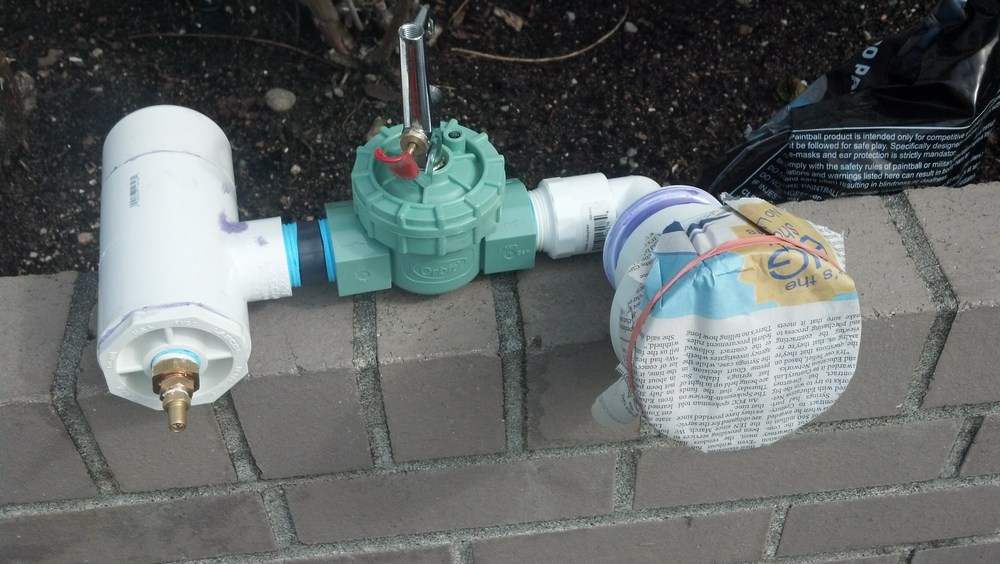

I definitely agree with Jack. I would never try to fill a device rated at less than 1000psi with a remote line from your CO2 tank or HPA paintball tank as you can easily spike the pressure over what you intend very rapidly and blow the crap out of yourself. I decided to go with the 12gram CO2 option as it is very portable and easy to use, and the small amount of CO2 in each one limits the danger and destructive potential of the system. As soon as I get a chance to video my mine with paintballs in it, I'll post the results.
The total cost for me to build one mine, (not counting the tire fill 12 gram adapter) was about $25 in PVC parts, the sprinkler valve with modification, the shraeder valve, and the brass 1/2" to 1/8" NPT reducing bushing. I didn't count tool cost or epoxy cost, or PVC cement in this, as I had that stuff lying around and it is used to do other things.

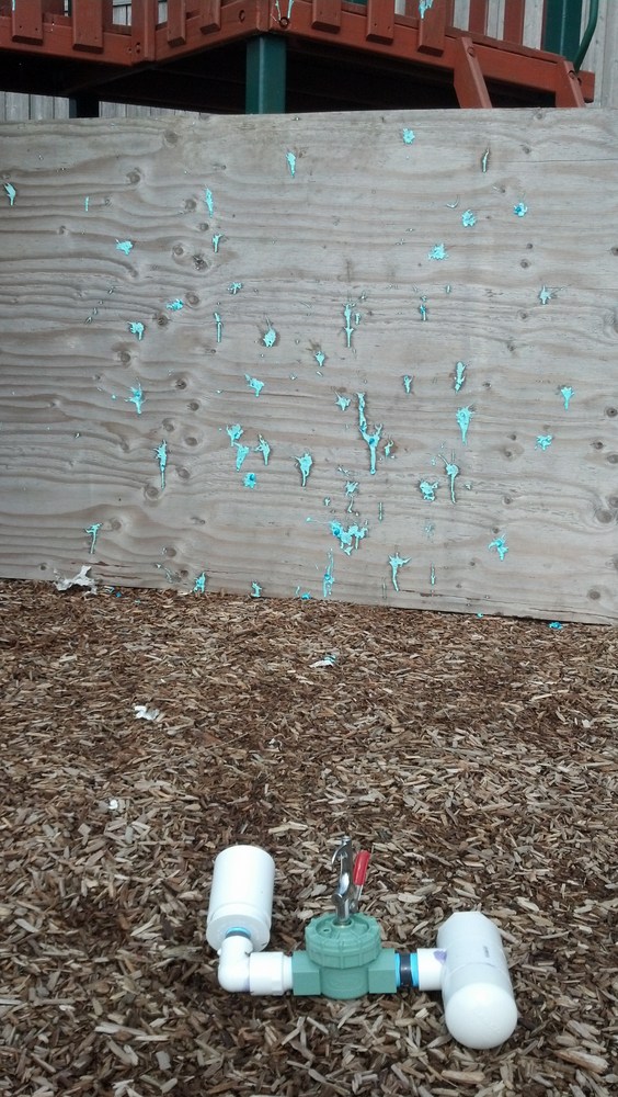

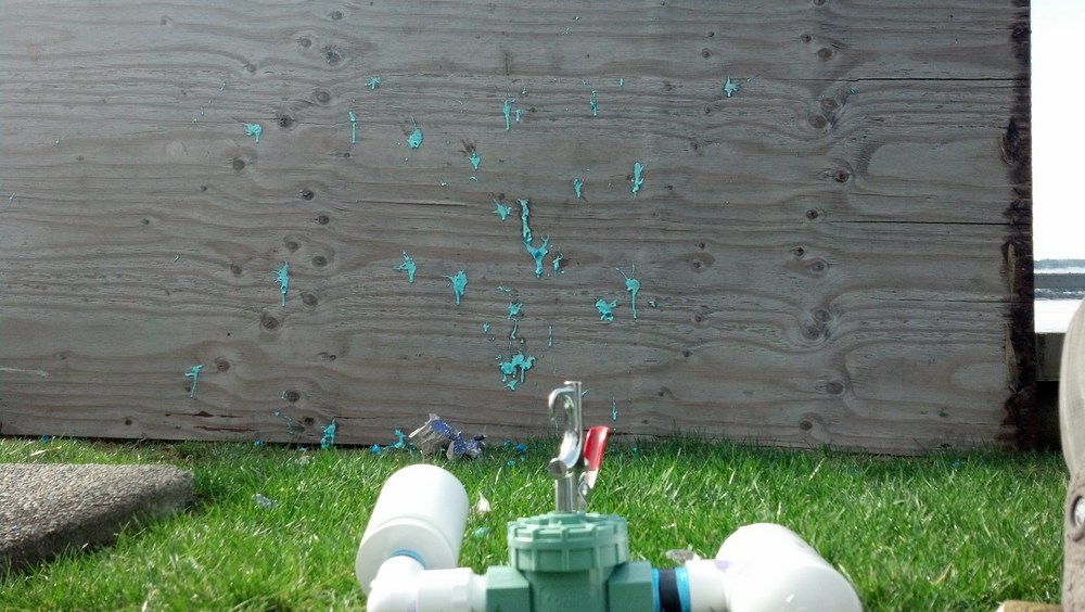

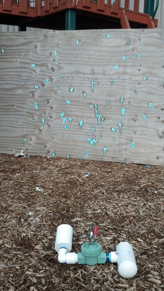

OK. Finally had enough free time to get this thing tested. Pics and Video to follow. Here is what I learned:

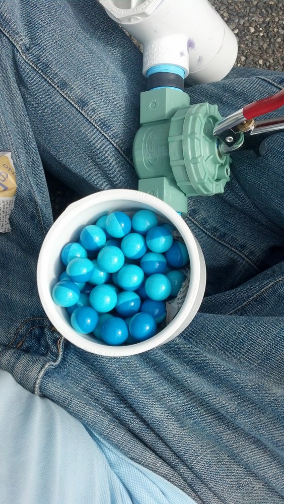

1. The overall design works well for liquid paint, powder, or paintballs.
2. When firing paintballs, it is better to switch to a straight 2" coupling for the barrel as opposed to the 2x3" expanding coupler. This is due to the fact that about 15% of the paintballs around the edge of the funnel shaped barrel will not be accelerated when the mine fires enough to reach breaking velocity. Switching to the straight coupling as a barrel fixes this and only decreases your payload by about 20%. It will still hold about 20 paintballs, which is more than enough. The funnel shape 2"x3" barrel still works fine for liquid paint and powder.
3. One 12 gram CO2 charge for this has plenty of power to break paintballs on a target at up to 15 feet distance from the mine. I didn't test it past that range, but I would not imagine that a trip-wire mine would need more than a 15 foot range.

5. The paintball load is helped by placing a small crumpled newspaper wadding at the base of the funnel to better allow acceleration of the payload.
6. A paintball load has better range, easier loading and way less hassle and mess than a liquid paint load.

Here's a video. Sorry it sucks. My phone doesn't have a wide enough angle to capture the spread...

As far as parts go, I just used the common Orbit watermaster jar-top valve that is super cheap here ($9) and the standard mod. I used schedule 80 1" irrigation pipe nipples to connect, and then some 2" schedule 40 PVC with a 2"x2"x1" T piece (threaded on the 1" side, smooth on the 2" sides, with associated caps as seen in the pics. I used brass fittings to get down to the 1/8" NPT to attach the schrader valve.
