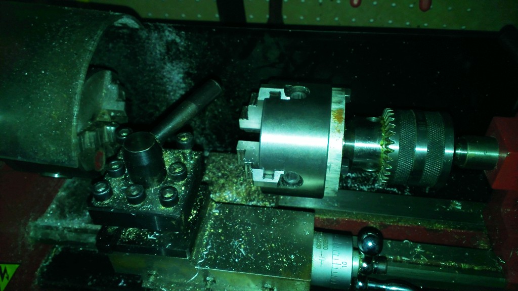

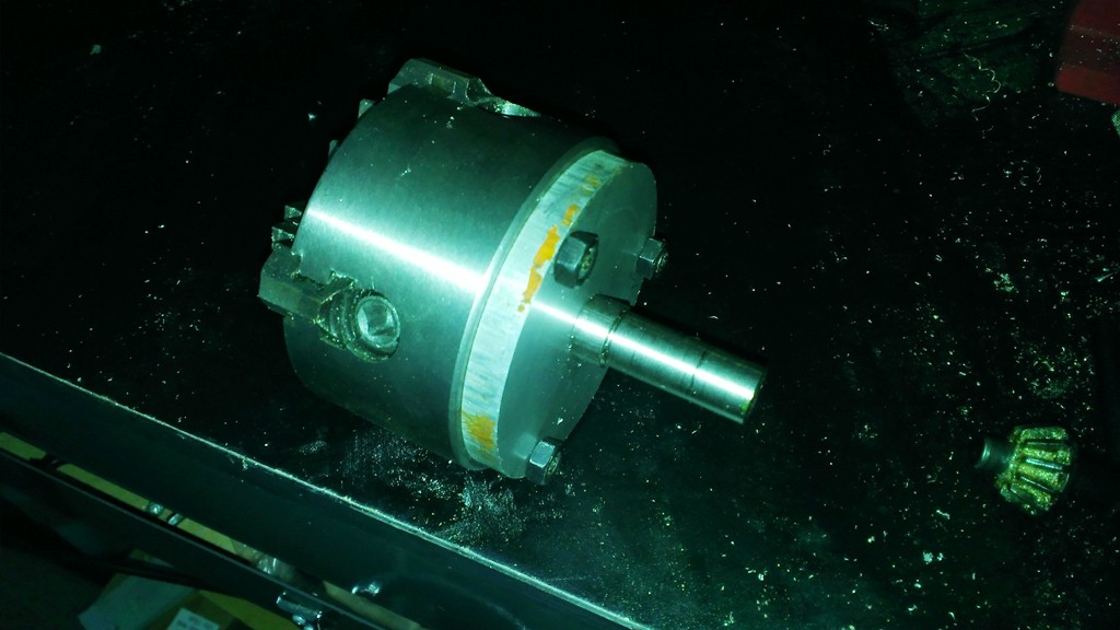

Thanks everyone for the input, anyway I managed to make it myself (perks of having machines, you can make your own tool)
Aluminium face plate (can't find same size in steel) and SS shank. Didn't have SS in hand big enough to make it MT2 taper, shame that I need the drill chuck to hold it, but it work so...
