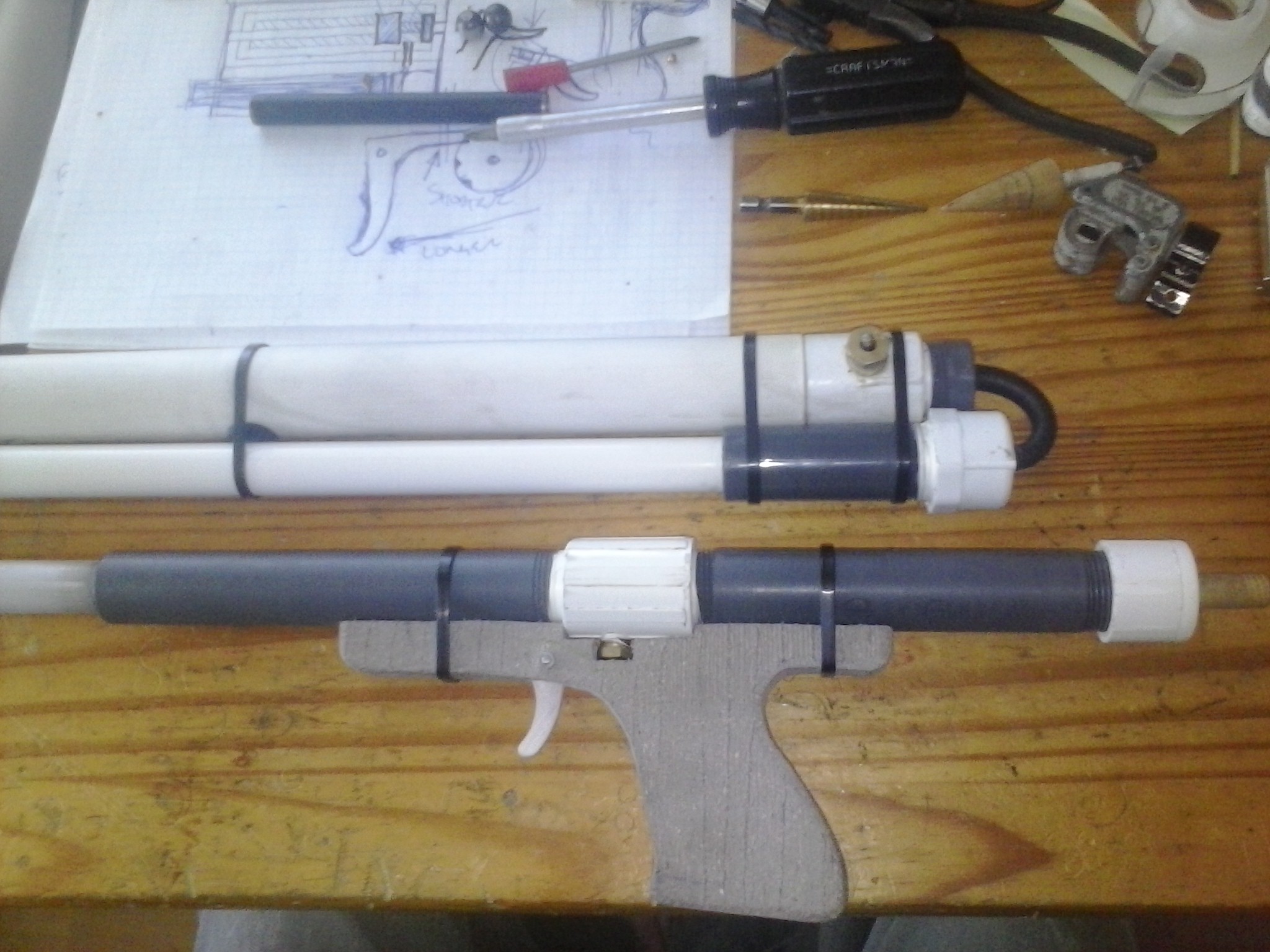

Reworked it and simplified more ,(that's always good ) here is what I came up with.
hammer will strike a custom pilot valve on the coaxial. under the coax is the pump tube. EASY!
I did try flipping the bottom photos so when uploaded they'd be upright , that didnt work .then I un-flipped them and re-uploaded and still the damn things go "belly up" every time , no matter how I load them , they are upside down ! *#&"!-$";(*#!!!! woo , i quit!

@jack - not yet , but I will soon I think. Is a diagram of that valve around somewhere? And for a random question , have you ever considered machining up a .45 caliber Crossman style pistol?
@brian - No cylinder action planned for these." Larger-caliber-single-shot-self-contained-coaxial" is how I describe these proto-types. I would however attempt one with a hammer-valve. My first hammer valve I made for .25 cal. a long time ago( now im looking at a box of .490 lead balls ...) was just epoxy poured into a pipe connector and hand-machined out. It worked excellent but I didn't have the skills then to make a decent copper gun for higher psi.
My intent is to tweak the design below from the pistol with handle to under-over style like the gun with no handle. This one has a rubber tube connecting pump to pilot area , this gets changed out to a brass connector. I'll move the exaust valve to the back , and smack it with my revolver-style hammer !
My reason is the if the one-way valve on the pump fails , the pump rod will eject toward the user. Not what I want to have resting on my cheek. So the volly gun below will turn into a huge under-over pistol with "revolver-style hammer" pilot trigger.Eh?

I've been too busy with "life" to finish my hammer mechanism , but I made this update incase someone is interested.
Re-worked pump and chamber attachment (now brass) and moved pilot vent button to rear.A medium rubber band on the proto-type hammer (photo above somewhere) was enough force to pop the pilot nicely at 80 psi ! Can't explain it all now , kid just woke up crying.
