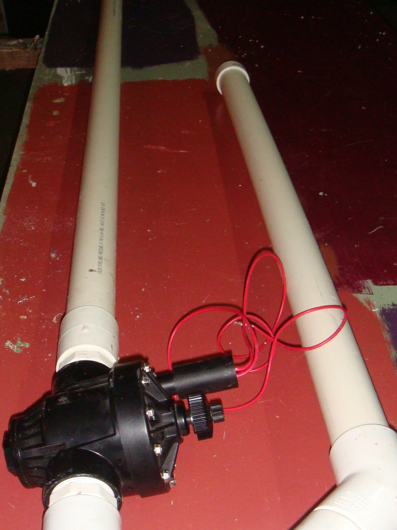

heres a pic
surfcaster
Posts: 17
Joined: Wed May 21, 2014 4:27 am
heres another

The solenoid valves open super slow. Modding the valve either with a blowgun or another smaller sprinkler valve I'll give you a dramatic increase in performance. You cannot have to large of pilot valve.
Using the solenoid, the valve opens with a whoosh. When you mod the valve with a blowgun they go pop, but when you pilot them with another sprinkler valve they go BANG!.
