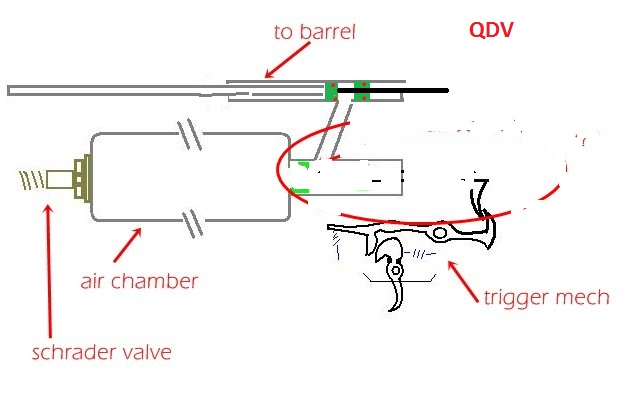

Trigger Mechanism, will it work?
Talk
Posts: 109
The attachment main components.JPG is no longer available
overview of the main setup
main components.JPG (34.06 KiB) Viewed 12149 times
how effective is this setup going to be eg: holding pressurized air,
maximum psi 700-800.
I think leakage can be avoided by using heavy duty rubber seals, let me know if you guys think this mech will work?

Sure it will work. I think someone on the airgun forums suggested the same setup. Make sure your chamber can withstand the pressure. Why not use a regular hammer valve or qev though?

Is your design meant to be a QDV ? Cuz i dond see how you will seal the air chamber/..700 psi will blow that up.. unless it is a QEV or a QDV or you got a O-ring on your piston and the sea; is against the walls of that pipe......

fenrir wrote:Why not use a regular hammer valve or qev though?
I think it would be really had to construct a hammer valve like the Crosman 1322 etc and i don't understand how QEV works never made an effort to even try understanding it and applying in any of the designs I ever thought of
bravootome wrote:Is your design meant to be a QDV ? Cuz i dond see how you will seal the air chamber/..700 psi will blow that up.. unless it is a QEV or a QDV or you got a O-ring on your piston and the sea; is against the walls of that pipe......
I looked for some QDV pics on google its kinda like a QDV ,I don't know if this mechanism is related to some thing i totally made this up myself because with this mech its easier to put all the parts in a wooden body and make it look like an l96 rifle.
blow up which part?
this part?

A QEV is far better, and allows you to multiple shoots..... i find it superior of hammer valves..
What make your rubber seal to stay there and seal the air chamber when you put 700 Psi inside the tank ? that bolt wont do it if only apply an equal oposite force...witch i dont see how you will do it.... As i said a piston with o-ring, should hold on.[youtube][/youtube]

poor drawing skills on ms paint, I think now you'll understand.

It should theoretically work if you can get a good seal but that bolt is going to be a missile and it is aiming right at you so if it brakes free you are going to have big problems. Fined out how a QEV works they are cheap and a much better solution, if you don't want to go down that road I suggest making a coaxial gun instead. That being said it is always the new things that no one thinks will work that end up being the best inventions.

I'll put the whole trigger mech part in a steel case so the bolt won't be a problem.

That set up is probably not going to work very effectively, if at all.
For starters the trigger would have to be applying an active force against the piston for it to seal correctly which would defy the whole concept you have going of an unbalanced valve,
And secondly you would have to have literally nanometers of play in the trigger mechanism to avoid a steady leak.
If you are really keen on this set up you would need to bolt to be in spool, as opposed to a face seal, which would eradicate the need for microscopic tolerances, but unless you have a lathe handy this is going to be nigh on impossible to do.
I would seriously consider the set up suggested by bravootome, along with having potentially better power you could easily and cheaply fabricate it from off the shelf parts,

Have a look: pneumatic-cannon-database/topic7457.html
I did remember your design Jack, but for starters you were only using 100 psi, on a small sealing face,as opposed to the 700 proposed in this design.
Also another thing is that your design used a flexible rubber seal and a trigger block which could be considered to be applying pressure to the rear of the seal in a similar way that a wedge would, which gave a bit more room for larger tolerances, also, the pivot for your trigger was nearly directly in the line of travel for the piston, which reduced to natural tendency for the trigger to rotate out of the way, and therefore preventing the valve from leaking.
As proposed here the design would have to be very certainly machined with a high level of precision, and certainly would be extremely subject to wear, It's not exactly a pneub friendly project, especially in comparison to something like a QEV or hammer valve based design.

Your idea seems that it would work, but a good question is how long is your reload going to take. If the design is somewhat to scale I think it would take forever to re load as well as be bulky and not fit correctly inside of a l96. I designed a qev set up for a l96, but it is a cartrige fed idea and is only half finished on spud files. I designed the rest on a notebook after basing an idea off of a bolt .22 rifle. One last question, how will you load it? Will it be a breech load or a muzzle load?
