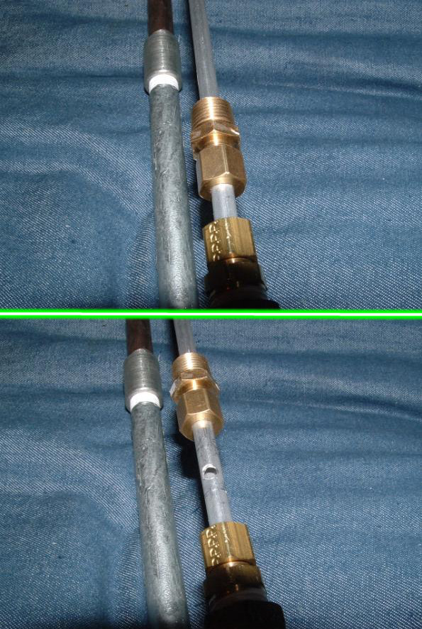

As for the breech loader, I made a BB gun a while back with a compression nut based one. Drill out the tubing stop, drill a hole the BB will fit in in the tubing, and slide the compression nut over the hole, tighten to seal, loosen to slide and load.
EDIT: rummaged up a picture
