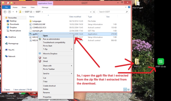

For some reason my computer automatically labelled it as a wps file!? Not sure if this matters.. I right clicked it (as you can see) then clicked extract files. This is what I have read on the internet as what I should do. If this is wrong please reference to this step and tell me below.
step 3
So I opened the zip file, then attempted to open the file named .EXE, I also read that this is what I am suppose to click on..

Once you have the zip file you need to extract all the files into a regular folder. Just click and drag the GGDT folder in the top level of the zip file onto your desktop. Then open that GGDT folder and click on GGDT4.6.exe file the system should properly find the "MSCH..." file.

Try this:
Right click on the ggdt.exe file, you should see a menu. On that menu, click on "Open as Administrator".

Ahh it's working! Thanks for the help guys! Opening it as administrator seemed to make it work!
