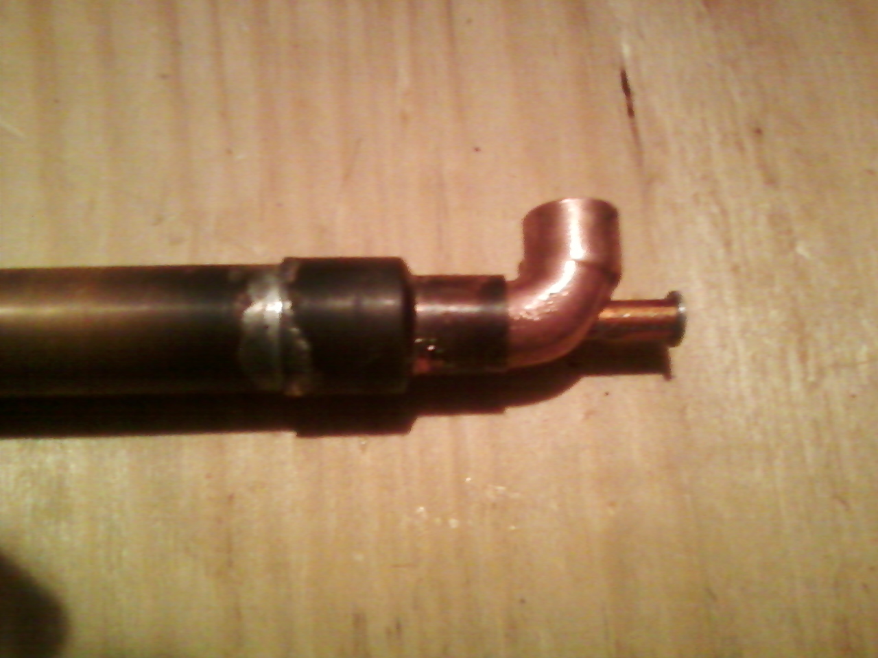

So, I'm working on a hammer valve operated air-gun, hoping to get it to work for airsoft as a shotgun. It's copper, so it will handle pressure better and more safely. There's a chance I'll try to convert it to propane power sometime, but that's not really important yet. I've got the proof of concept working okay, except for one little problem...

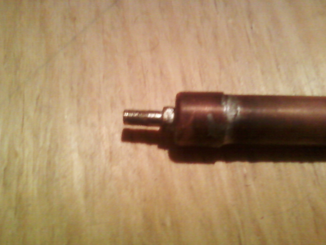

I'm charging it via a Schrader valve for now. The copper end cap didn't really seem sturdy enough to hold the Shrader valve threads, so I soldered the valve to the pipe. Unfortunately, that melted the Shrader's o-rings and I've got a steady leak.
Help?! Is there anything you guys can think of? Should I find some way to thicken the end cap to hold the threads without solder, or am I going to have to figure out a different charging valve?

Removing the core from the schrader before soldering would have seemed fairly obvious. Now that the core is fubar'ed, go to the auto parts or bicycle parts store and purchase a replacement core and the tool to change it.
Many different tools to remove the valve core, and whatever store you go to will likely have at least a couple options. This is about as simple as it gets...

That was my initial thought, Gippeto, but I was under the impression that the valve body itself has an o-ring in it. I guess I was wrong?

mako wrote: I guess I was wrong?
No o-ring in the body of a schrader valve...all seals are part of the core.

Hahahaha. I guess I can live with being wrong, if it means less work in the long run. :lol:

Edit: I got the hammer valve sealing properly and fixed the Schrader valve leak!
