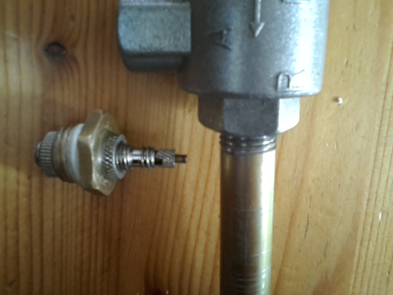

Got some hydraulic tubing for the barrel, a piece of 20cm and one of 40cm, with thread ends so it can be screwed directly into the QEV. This is to save space and money.

Update:
We've had a lot of issues so far.
1. The presta valve is not suitable as a pilot valve, since it's flow is too limited.
We had to use one of those ebay blue slider valves instead.
2. The QEV we intended to use didn't work. The piston didn't move very smoothly, and was a lot bigger than the piston in the generic black box qev. The springs I normally use didn't work for this type of QEV, because they're too weak.
Does anyone know where to find suitable springs? Can I make them myself?
3. We failed at soldering, so we filled some holes with glue.
The thing we have now is not nearly as compact as originally planned, so we might just turn it into a light weight rifle.
