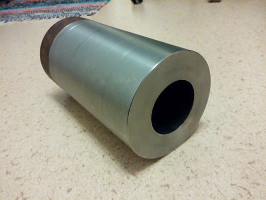

Today I started machining a chamber for a hybrid that I have wanted to build for a long time. I recently started studying to be a machinist so I now have access to large lathes and mills to do my projects on. Here is a picture of the partially machined chamber:
Chamber
Chamber
It is 143mm OD, 75mm ID and about 270mm long at the moment. The OD is in its final dimension but the inside surface has not yet been machined, so it will probably be 77 or 78mm, depending on how much the hole is off center, I havent measured that yet but it is in the 0.5-1mm range. It will have a chamber volume of about 1250-1300cc depending on the final chamber ID.

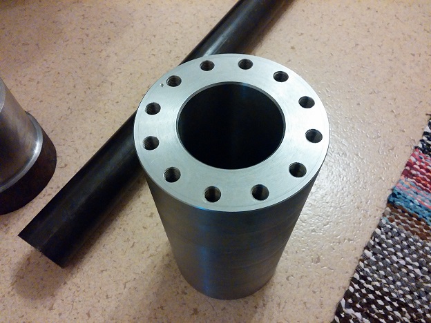

I got some machining done today, the chamber piece has now fully machined surfaces and tomorrow I will drill and tap some holes to the ends for attaching the end pieces. The chamber ID ended up at 77.6mm. There is not much more to see at the parts at the moment, I will probably take a picture of the chamber tomorrow if I get the bolt circles all drilled and tapped.
EDIT: Bolt circle is now done on one end, it has 12 M12 bolt holes.

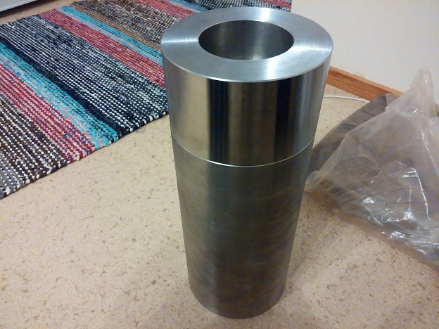

I have done some progress during the few weeks since my last update. The chamber cap is now in good shape, I still have to bore the hole to 55mm ID and then do some drilling and tapping and an o-ring groove.
A few pictures of it:
The smaller OD goes inside the chamber
The barrel will be attached here
It will be placed like this

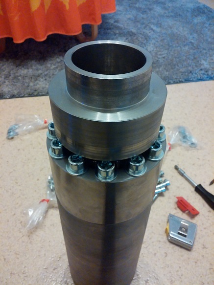

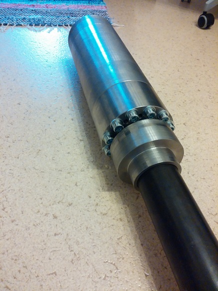

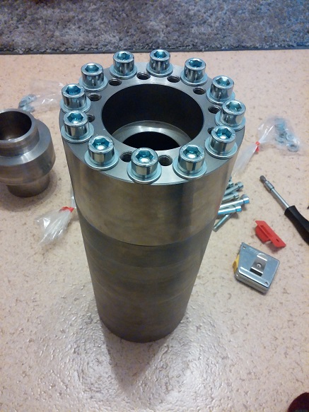

Some time has passed and I have done lots of progress on the cannon:
There are some holes to be drilled and tapped so that I can get all the bolts screwed in but this is basically what it will look like. I am still not sure if I will weld the barrel in place or if I will make some kind of bolt clamp or something to keep it in place.
