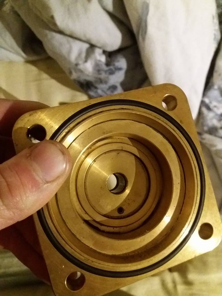

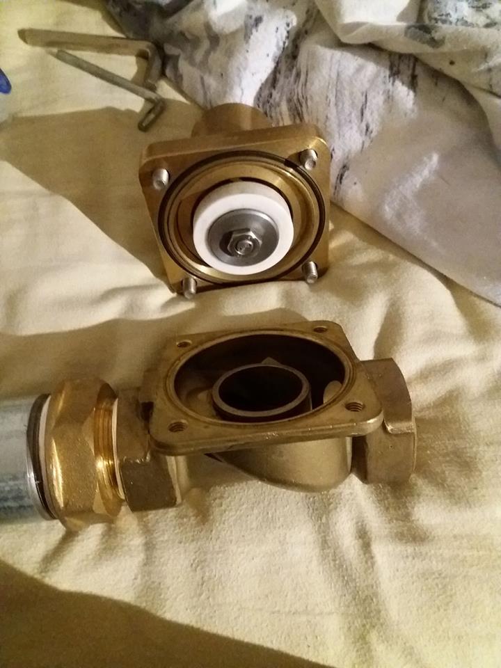

Hey guys, i'm thinking of turning my pneumatic piston cannon into a piston-hybrid. Already got a shorter chamber, but i'd still like a second opinion on the valve i would like to use as it is a pre-made valve instead of a custom built one.
I'm thinking of increasing the pilot hole from 1/8 to 1/4, drill a hole into the piston stem and thread it, add a few bolts and discs and an O-ring. Then solder a piece of copper pipe to a 1/4 fitting into which the O-ring fit's snugly, screw it into place and when the valve is forced open the O-ring will pop past the pipe and release all the remaining pilot air.
Valve split in half
Valve split in half
Closed
Closed
Open
Open

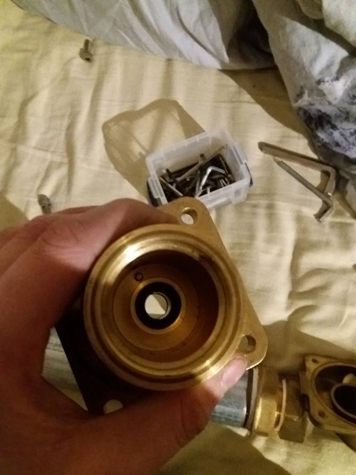

Top view of the pilot with cap removed
Piston
Piston
Piston 2
Piston 2
Where the sealing face of the piston is, thinking of adding a big rubber disc to dampen the piston during firing.
Piston stem seal
Piston stem seal

Thanks for replying. The pilot and chamber are in no ways connected, as you can see, the chamber sealing face of the piston is larger then the sealing face on the pilot side. So the pilot pressure needs to be slightly higher than the chamber pressure in order to keep the valve shut.
Before i knew that, i tried to make a connection between pilot and chamber for easier filling. The correction of that mistake can be seen at picture 7 as a small set screw where the hole once was.
The way it would have normally opened was that the pilot side has 2 inlets; the one on top which i use pushes the piston down. And the one on the side (not visible) actually pushes the piston up. So this was some kind of pneumatically controlled venting valve or some sort.
On pictures 7 and 8 you can see the valve body has 1 rubber "disc" and 2 O-rings to keep it all airtight. On pic 7 i plan to add a rubber disc to dampen the blow of the piston shooting upwards.
The pilot chamber is over 1cm thick brass, would be nasty if fuel got into there and ignited... I'd like to take it to x5 mixes with a remote set up. Just not really sure at what pressure the valve needs to be kept shut tho.
