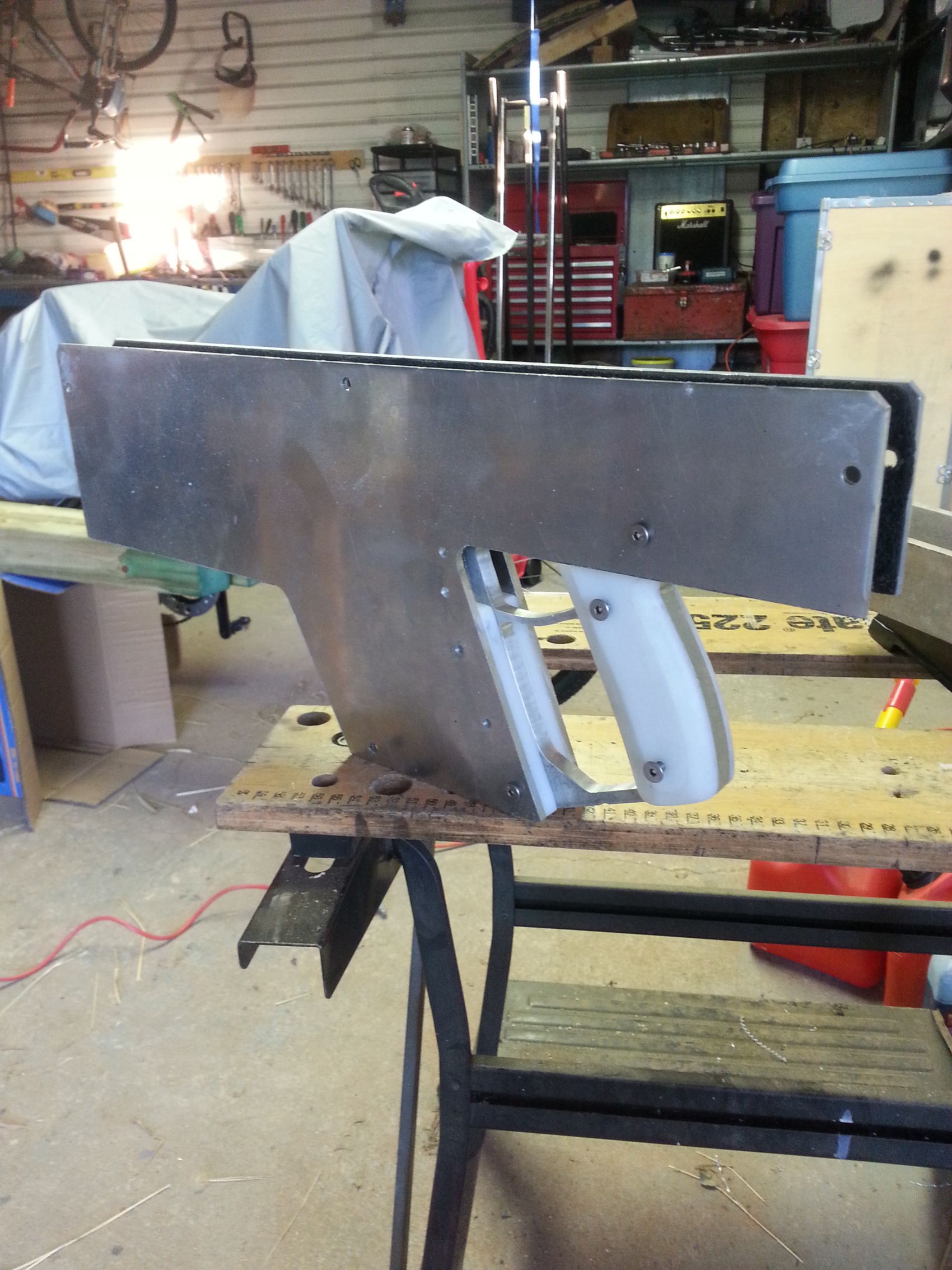

Started getting some more parts together
- farcticox1
- Sergeant
- Posts: 1087
- Has thanked: 69 times
- Been thanked: 103 times
First trial assembly of the main body

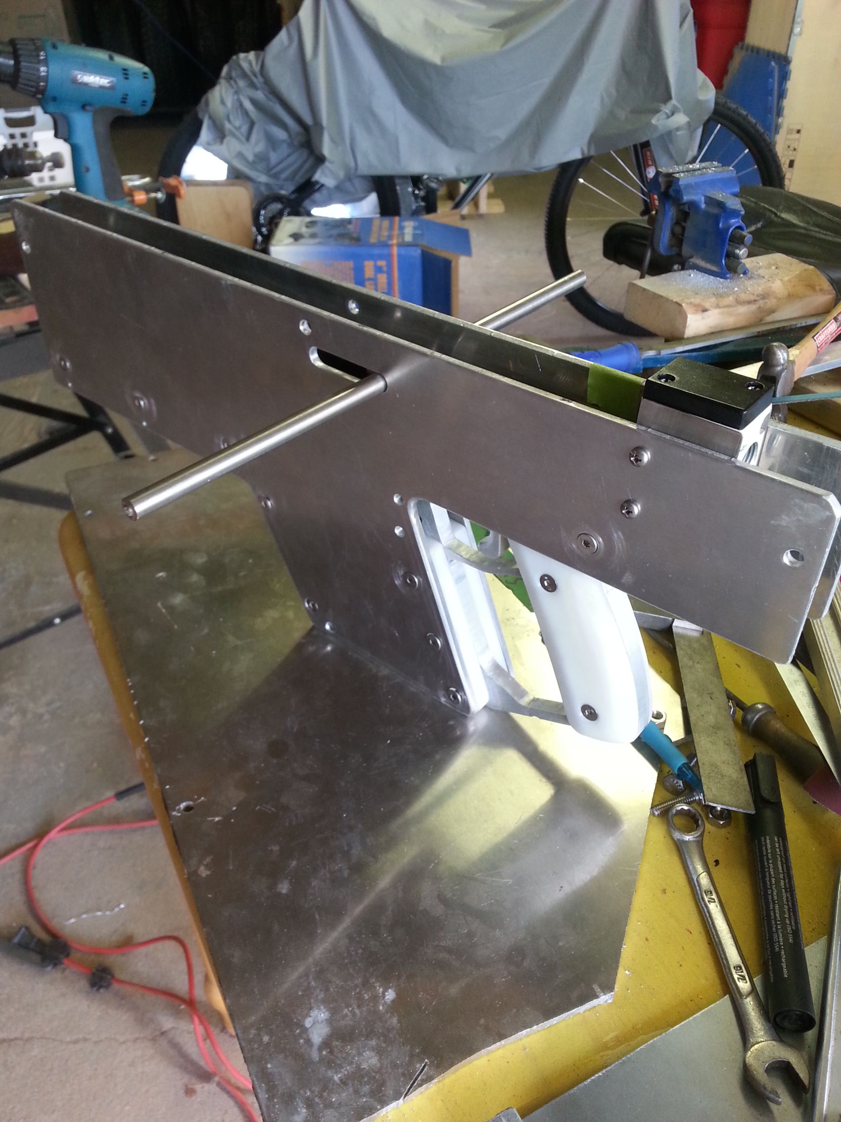

Some drilling, tapping and countersinking later.

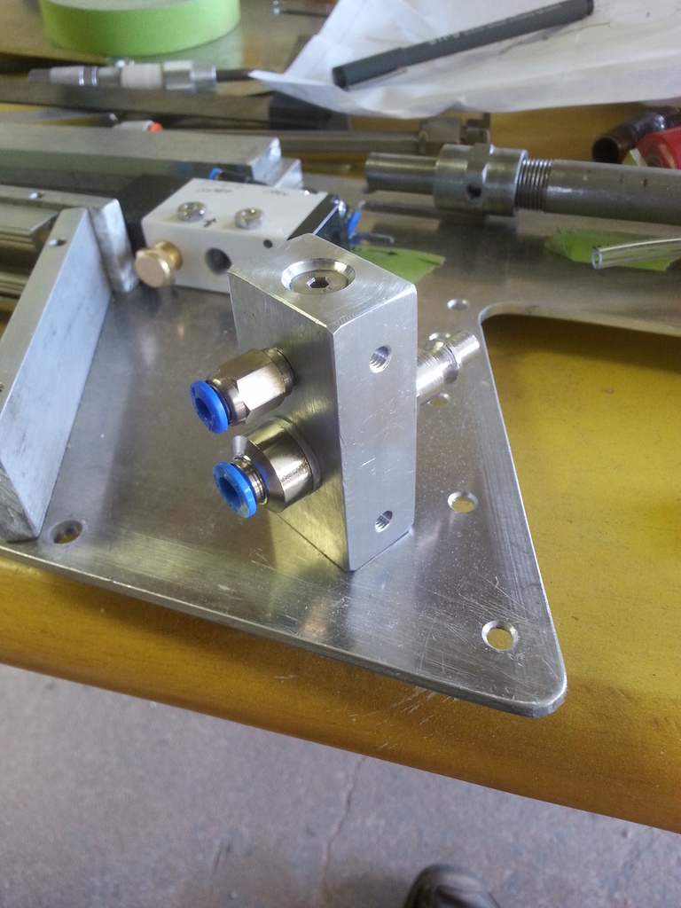

Another part made and fitted today, manifold for the air supply, 4mm for the pilot and 6mm to the chamber,

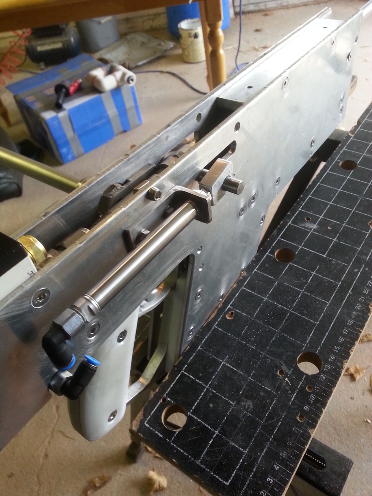

The loading system seems to work OK, just needs a bit of finishing
BBs in the tube, breech closed Breech opened by acuater, first ball is held by magnet (I haven't fixed it in yet)

Got it all fitted in nicely

I assume the pneumatic piston on the right side will cycle the bolt automatically?
- farcticox1
- Sergeant
- Posts: 1087
Yes, that is the plan, nothing has been powered yet though.

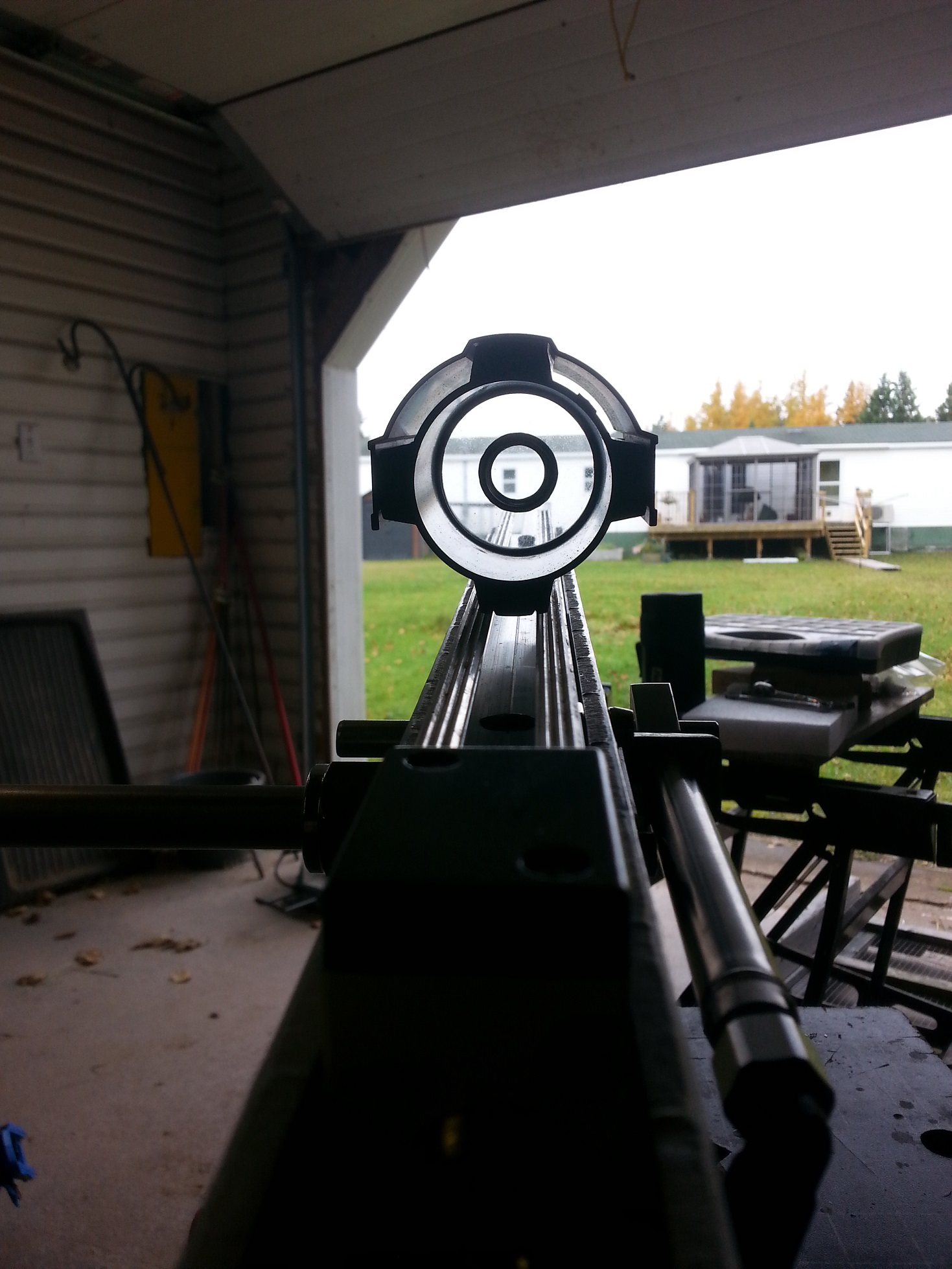

Found a cover of an old CCTV camera, it's gonna make a sweet sight, going to have a lazer pointer as well.
- Labtecpower
- Posts: 1297
- Location: Pyongyang
- Has thanked: 5 times
- Been thanked: 13 times
Nice work! I'll be keeping an eye on this

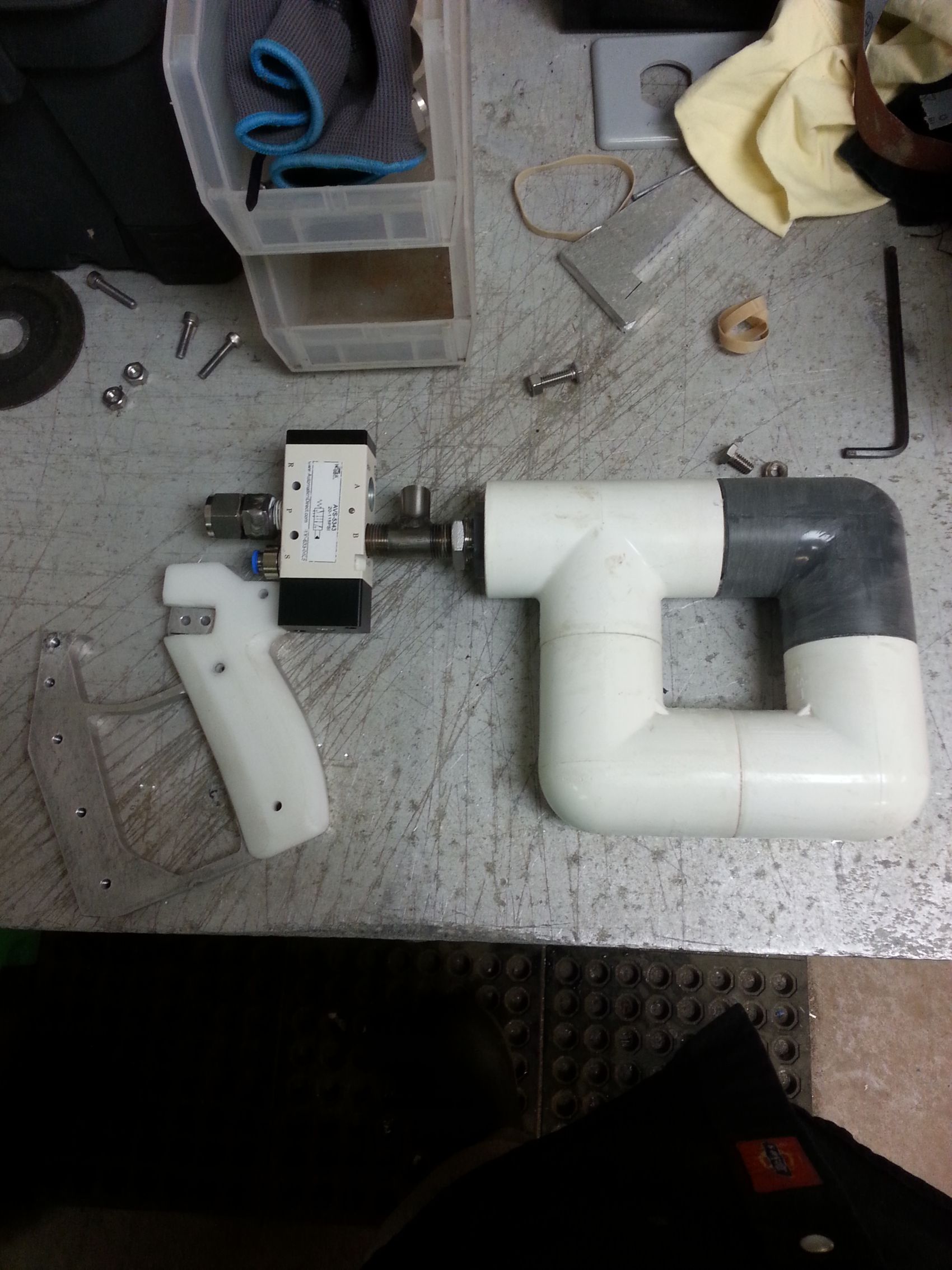

I have named it 'BFG No. 7' because I must have had at least 6 major design ideas before I got this far
And I have started on the next one
and parts for another
