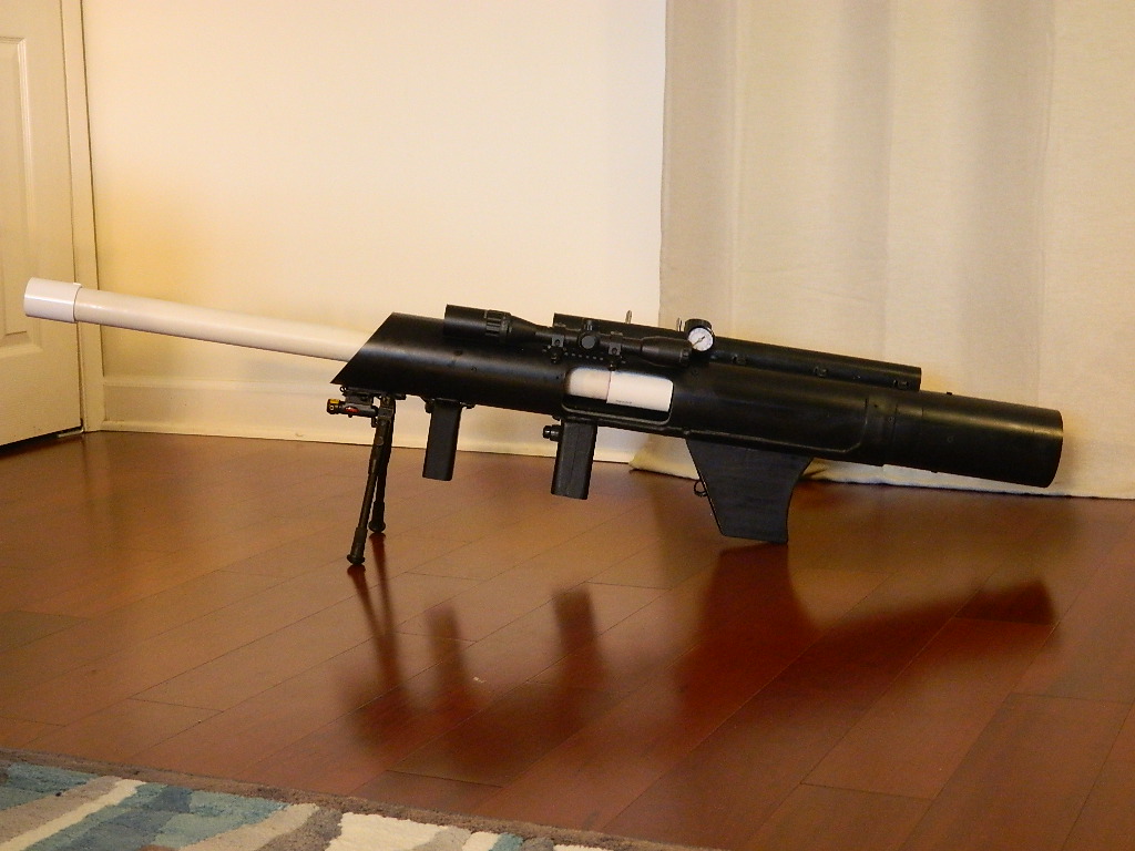

Here is the newest addition to the family! I call it "The Jackal", a silly reference to the Bruce Willis movie.
And a walk-through of the cannon:
The Specs:
- 36" x 1.5" SCH40 PVC Rifled Barrel
- Bolt action floating barrel
- 100 cubic inch 3" ABS combustion chamber
- Triple gap ignition spark array
- Integrated 12v rechargeable battery pack (in shoulder stock)
- 10 Watt chamber fan (that's powerful)
- AA Battery BBQ igniter
- 20kV Rated Ignition wire
- Rain-proof cover plates for all wiring
- On-board metered propane injection system
- Re-purposed on-board fog horn propane tank
- 1" ball valve vent
- 4" ABS housing
The barrel I got from Jeremy at Spudtech. Thank you!!! I think I put this finely crafted barrel to good use.
I made ammo out of flour using a handmade plunger mold and dipped the bullets in wax to seal and catch the rifling. The second recipe worked very well!

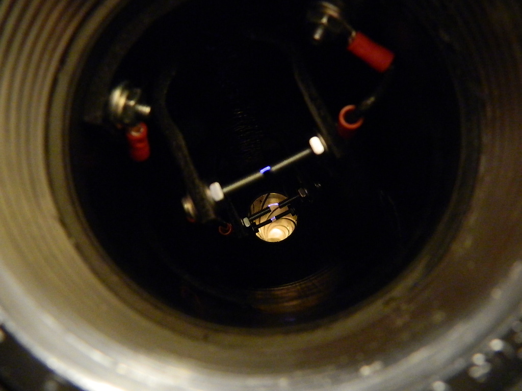

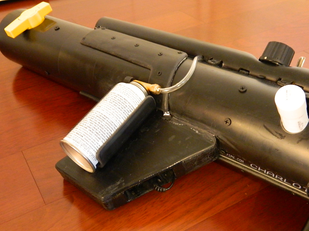

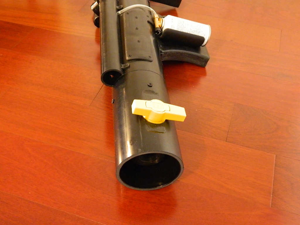

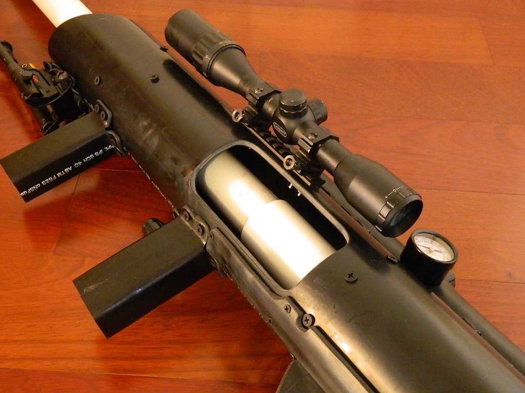

Two questions; one you said you were using ABS, does some ABS come pressure rated? I wouldn't fancy having that rupture with your cheek pressed against it! The second question is how did you seal the bolt action mechanism? I have a general guess that it involves the actual chamber and the barrel attached to a sort of fake housing chamber, sealed with O-Rings?

3.) Any details on the electronics? Or is it just a simple switch and battery to the fan.

2) The barrel is sealed using the pipe tee and an oring. The barrel slides fully into the ABS bushing so there is a friction fit. Vaseline is used to get it in all the way. Then an oring goes around the barrel and sits against the edge of the tee that holds the bolt. The oring is pressed on the other side against the ABS bushing and the bolt action has a slide wedge that smashes it together. The oring actually gets permanently flattened with the pressure. No leaks!

4) No special circuitry on the electronics outside the 12v battery box. I just turn the fan on and off at the box inside the shoulder stock
