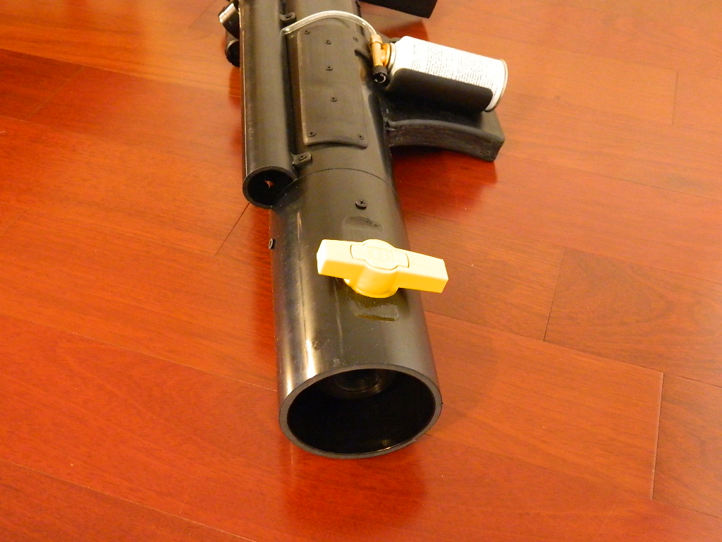

Hi Again Spudders!
Here is the newest addition to the family! I call it "The Jackal", a silly reference to the Bruce Willis movie.
And a walk-through of the cannon:
The Specs:
- 36" x 1.5" SCH40 PVC Rifled Barrel
- Bolt action floating barrel
- 100 cubic inch 3" ABS combustion chamber
- Triple gap ignition spark array
- Integrated 12v rechargeable battery pack (in shoulder stock)
- 10 Watt chamber fan (that's powerful)
- AA Battery BBQ igniter
- 20kV Rated Ignition wire
- Rain-proof cover plates for all wiring
- On-board metered propane injection system
- Re-purposed on-board fog horn propane tank
- 1" ball valve vent
- 4" ABS housing
The barrel I got from Jeremy at Spudtech. Thank you!!! I think I put this finely crafted barrel to good use.
I made ammo out of flour using a handmade plunger mold and dipped the bullets in wax to seal and catch the rifling. The second recipe worked very well!

Bolt Action Close-up
Breech Close-Up
Breech Close-Up
Air Horn Propane Tank
Hidden Ball Valve
Hidden Ball Valve

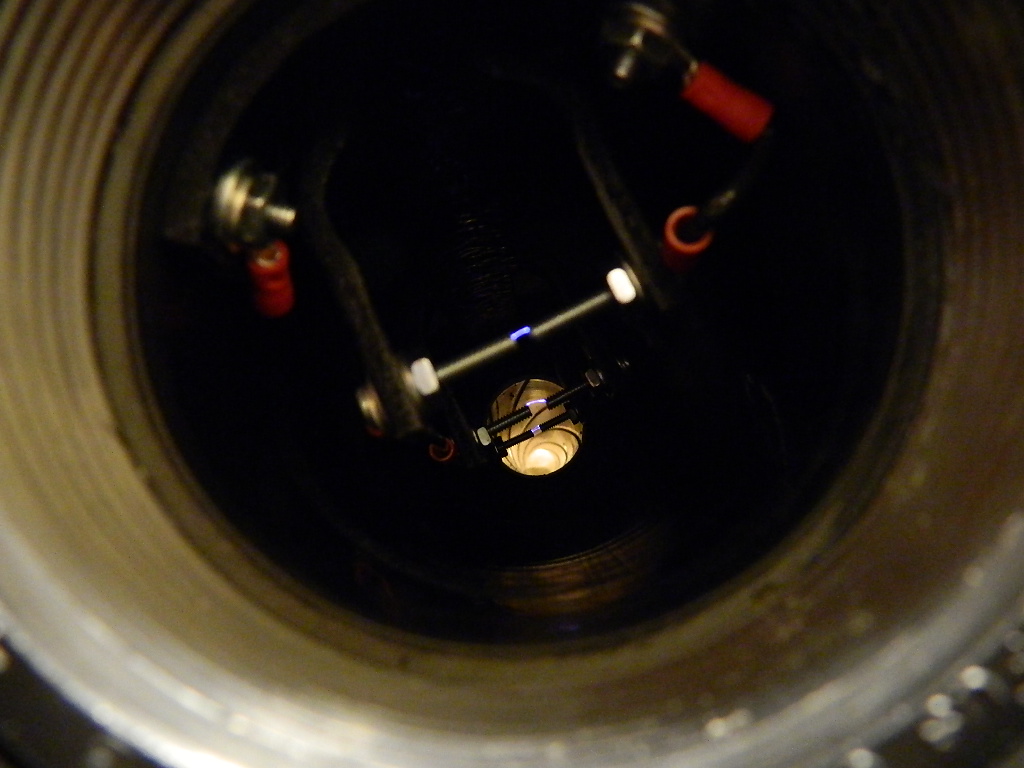

Spark Gap Array
Spark Gap Array
Close-Up Spark Array
Triple Sparks!
Triple Sparks!

1.) What kind of "10 watt chamber fan" do you have in the chamber? Is it brushless? Not that it really matters if you handle the cannon safely, I'm just curious.
2.) How does the barrel seal against the chamber?
3.) Any details on the electronics? Or is it just a simple switch and battery to the fan.

1) The ABS is cell core DWV pipe not pressure rated. I still use it for a few reasons. One is that it visibly deforms before failure. I have never had it fail on me, besides a 3" male adapter break because of a drop. Another reason is this video:
There are two layers of pipe protecting my head from the combustion, so I've got that going for me too.
2) The barrel is sealed using the pipe tee and an oring. The barrel slides fully into the ABS bushing so there is a friction fit. Vaseline is used to get it in all the way. Then an oring goes around the barrel and sits against the edge of the tee that holds the bolt. The oring is pressed on the other side against the ABS bushing and the bolt action has a slide wedge that smashes it together. The oring actually gets permanently flattened with the pressure. No leaks!
3) This was the fan I used: http://www.ebay.com/itm/Sunon-60mm-x-38 ... SwVupTmSf5
It's a beast!!! and brushless too.
4) No special circuitry on the electronics outside the 12v battery box. I just turn the fan on and off at the box inside the shoulder stock
5) I used flour because I wanted to make consistent ammo that was still okay for the environment. Potatoes are great, but they are not the same each time. Flour is cheap too and can be binded with just water. It's great for survival biscuits too! I could have used concrete, but it might have scratched up the nice PVC barrel.
I'm thinking of making a disassembly video so you all can see how it was constructed better because I'm not sure if I explained the barrel sealing well.
