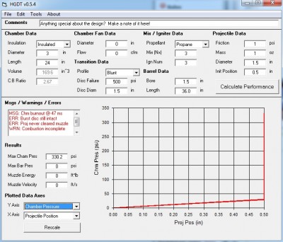

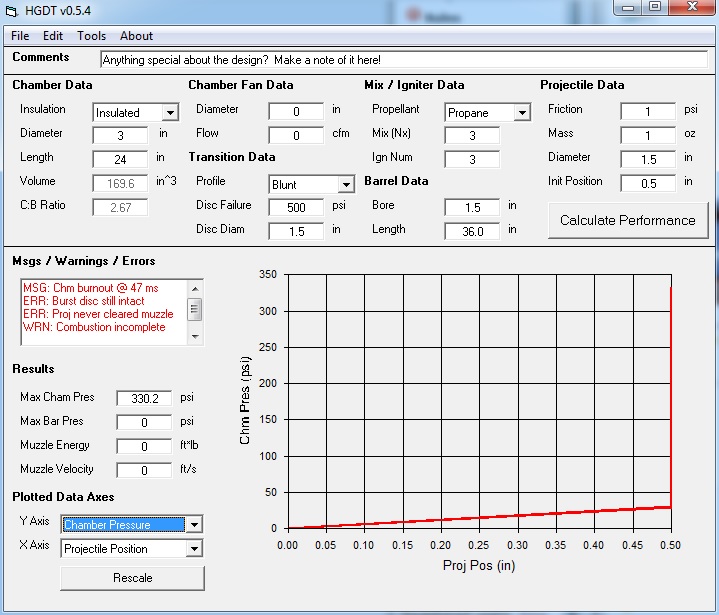

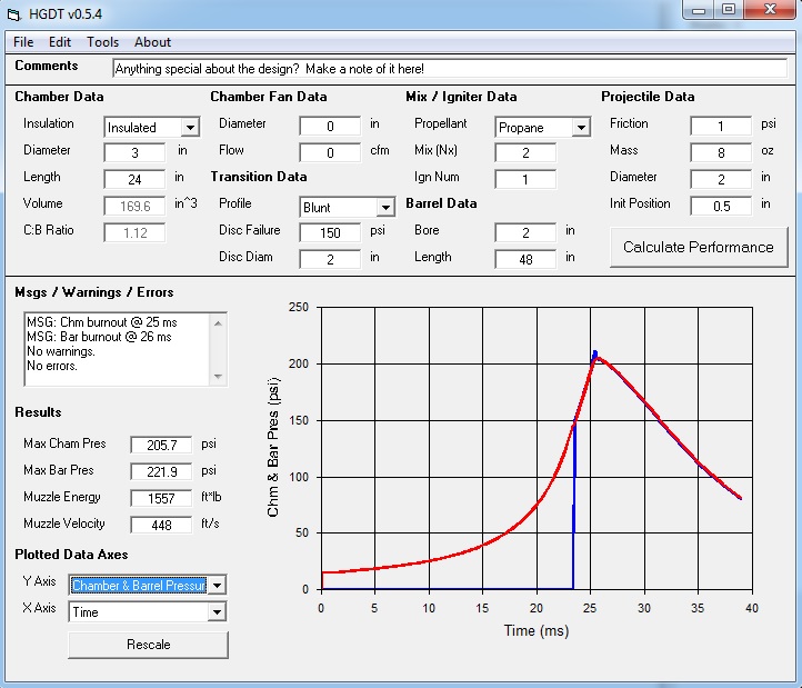

Here's an HGDT simulation of a 3 inch chamber hybrid at 3X where the burst disc is too strong and doesn't burst, a worst case scenario giving you maximum chamber pressure:
As you can see, it maxes out at 330 psi.
Schedule 80 PVC has a burst pressure of 1200 psi and working pressure of 225 psi, safe to say that even in this scenario a correctly manufactured pipe would not burst. In practice of course if you run only at 2X and use an appropriate burst disk, chances of a chamber rupture are virtually zero.
Nothing is 100% safe of course, but in this case competent assembly of fittings is much more critical, as it is more probable that a poorly attached fitting will fail than the material itself.

Thank you so much for that data, unfortunately, I cannot use HGDT as I have a new computer, which is a Chromebookjackssmirkingrevenge wrote:Here's an HGDT simulation of a 3 inch chamber hybrid at 3X where the burst disc is too strong and doesn't burst, a worst case scenario giving you maximum chamber pressure:

The latter, you have to be absolutely sure that you weld it according to the manufacturer's recommendations, otherwise you might get an endcap as a projectile.You mention that it is more likely for a poorly attached fitting to fail than the pipe itself, would this fail because of the manufacturer/material or someone who poorly solvent welds the pieces together?

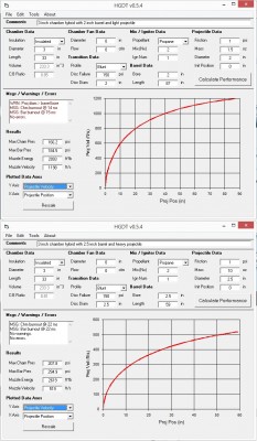

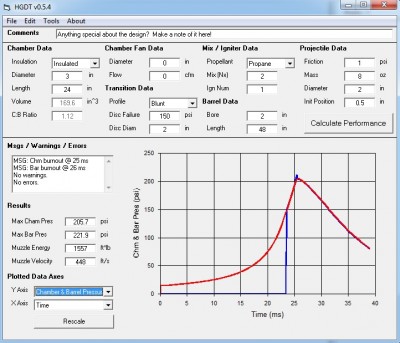

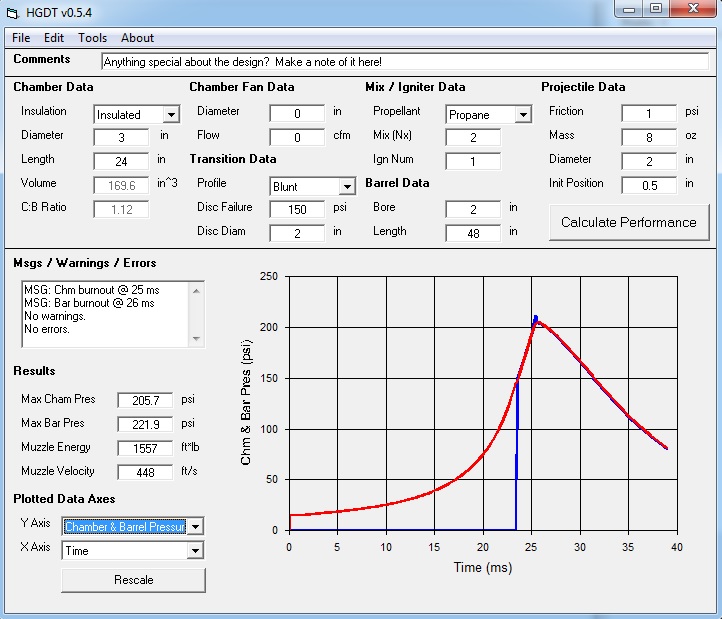

No worries, I went head and ran more typical numbers and as you can see with a 4 inch long potato slug you'll have the same energy as a .44 MagnumThank you so much for replying to and helping me.

jackssmirkingrevenge wrote: No worries, I went head and ran more typical numbers and as you can see with a 4 inch long potato slug you'll have the same energy as a .44 MagnumNote also that peak pressure does not exceed 250 psi, well within the limits of the materials if correctly put together.
That is so awesome, I would never have dreamed of that much power!! I know it seems inferior to all you welding machinists, but it is more than I would have dreamed of!!

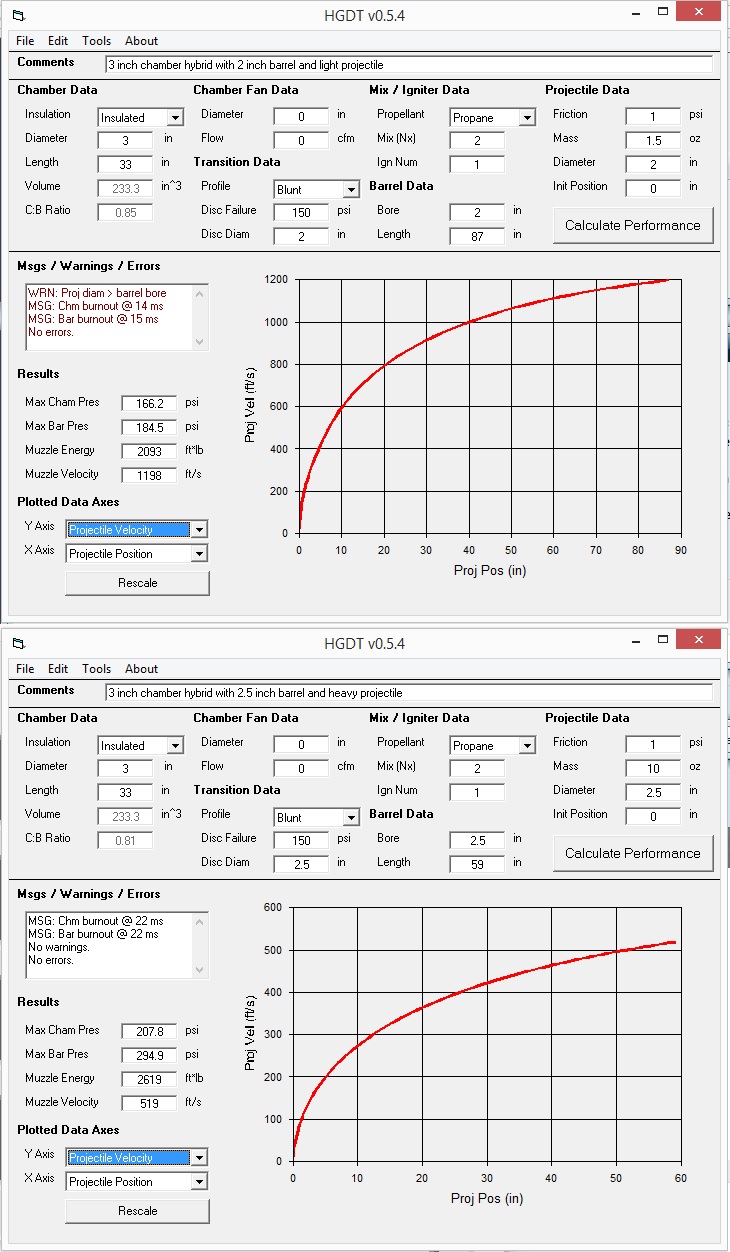

#1 I might as well give the specifics of the chamber and length if this is going to be completely accurate, chamber is 231.92" cubic inches, or 3" Diameter(Could this be too small of a diameter relative to a barrel of 2" or 2.5"? Should I change the Diameter to 4", keeping the cubic inches constant?) with 3' in Length if it's straight(This will be an over/under cannon),
barrel(s) will be 288.524" cubic inches, or 2" Diameter at 87.5 inches in Length and 2.5" Diameter at 58.78125 inches in Length.

Hot gas and the instant "valve" certainly gives hybrids the edge when it comes to raw power.That is so awesome, I would never have dreamed of that much power!! I know it seems inferior to all you welding machinists, but it is more than I would have dreamed of!!
Don't forget that with great power comes great responsibility
No, you're fine with the 3" - smaller diameter is stronger and safer.(Could this be too small of a diameter relative to a barrel of 2" or 2.5"? Should I change the Diameter to 4", keeping the cubic inches constant?)
The percentage difference is too low to be significant compared to the safety factors involved.I am also considering using MAPP instead of propane. It sounds like it would be pushing it, but is it still safe to use in PVC
Well you'd better sit down for this then, with your numbers HGDT suggests that with a lightweight projectile in the 2 inch barrel you could go supersonic, while a heavy projectile in the 2.5 inch barrel you'll have muzzle energies approaching a 12 gauge shotgun slug:Again thanks for your time, that comment about it's energy relative to a .44 Magnum has completely made my day!
