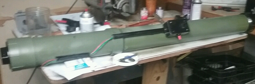

I'm about to build my second cannon and was hoping some of you veterans would offer some advice and/or stop me from ending up with a bunch of shrapnel in my head.
Design is fairly simple (I think)-
Expansion chamber is 4" x 15" Sch40 PVC
Barrel is 3" x 30" Sch40 PVC
12v fan
5 Point pulse grill igniter
The 3" barrel will be shrouded within a 4" section of cell core pvc to give the entire gun a uniform diameter. I'm trying to mock up an AT-4.
Any thoughts would be greatly appreciated.
Thanks!

It should work just fine, but you could boost the power by trying to get the combustion chamber to barrel ratio closer to 1.5:1
Just remember, a measured amount of a gaseous propellant (propane, butane, methane) will always be 100x better than just spraying in hairspray.
Other than those bits of advice, you're good to go! Be sure to post pictures of the build!
Hear hear!Cthulhu wrote:Just remember, a measured amount of a gaseous propellant (propane, butane, methane) will always be 100x better than just spraying in hairspray.
Also, a couple of holes at the end of the barrel allowing gas to bleed into the shroud would absorb some noise, especially if you packed some heavy gauge steel wool swabbed with lithium grease... if one were so inclined.
Regarding the 1:5:1 chamber/barrel ratio-
If I understand correctly (and can do math) a 10"x4" chamber with a 30"x2" barrel would be 1:5:1, correct?
Also, any suggestion as to what I might fire from a 3" barrel? I was considering small grapefruit or oranges. Potatoes obviously, if I can find some with adequate size.

Anything you can fit down the barrel... :bigsmurf:ski0724 wrote:any suggestion as to what I might fire from a 3" barrel? I was considering small grapefruit or oranges. Potatoes obviously, if I can find some with adequate size.

You can put almost anything down the barrel with some paper towels acting as a wad.ski0724 wrote: Also, any suggestion as to what I might fire from a 3" barrel? I was considering small grapefruit or oranges. Potatoes obviously, if I can find some with adequate size.
Personally, I like to shoot Easter eggs filled with flour for a nice poof of smoke when they hit the ground. Maybe shove a bunch of them down the barrel wrapped in a paper towel?
Looks good!
For a 3" barrel, an empty soup can wrapped with tape to built it up to the correct diameter makes a great sabot, light yet strong:
This will allow you to launch virtually anything that fits in the barrel - even irregularly shaped objects like for example your little brother's favorite He-Man action figure - without losing any power from blow-by.
Thanks to all for your help. After the first couple shots, I had already redesigned the gun, so I made a gift of it to a friend; I've been trying to generate some local intetest in pumpkin chucking and it seemed like a good way to start.
The new gun will be essentially the same, only with a 2" barrel, a 5 point electric pulse ignitor, and a closer eye toward the 1:5:1 chamber/barrel ratio. Also: no more oranges- they fly great but the juice makes a horrific mess when you stuff them down the barrel.
A final question - would the addition of burst discs be a significant benefit to this design? I'm not quite confident enough of my abilities yet to attempt a metered propane gun yet.
Thanks to all!
Thanks to all!
Reason: Embedded video.
Good stuff! For this kind of launcher, a burst disc won't have a huge effect. You can meter propane with only a large syringe and some basic math, no need to make a complex manometric setup. Give it a go, it is the best way to optimize performance:ski0724 wrote:A final question - would the addition of burst discs be a significant benefit to this design? I'm not quite confident enough of my abilities yet to attempt a metered propane gun yet.
