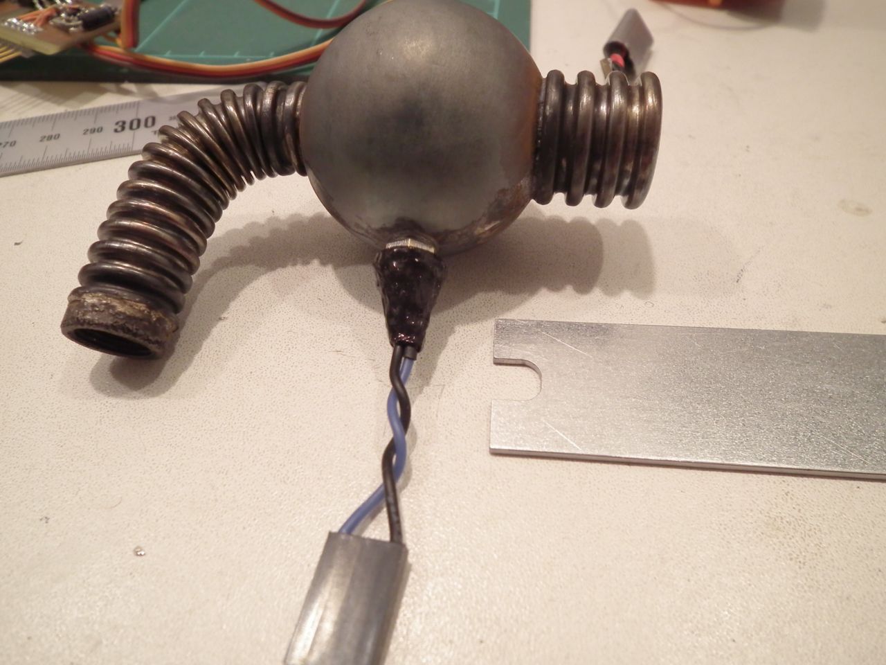

This project showoff has got me working a bit more on the project. I just finished a new adapter for the large "barbecue" propane tank for filling the Express canisters with pure propane. The old adapter was way bigger and had too many pockets where atmospheric air could be trapped, and I think some of it has gotten into the small Express canister. It's not causing any safety hazard regarding combustion of the propane gas inside the small canister, but it could introduce moisture to the inside of the canister walls, making them corrode from the inside and weakening the canisters. It has definitely had an impact on the static pressure of the canister, it should be around 8 bar at room temperature, but was lower at around 7 bar. So I emptied the canister and used the new adapter for filling the canister with pure propane. The pressure is now the expected 8 bar.

Currently I'm working on a good way to regulate the gas flow from the canister to the gas mixer. I have been using the valve from the weed burner to regulate the flow directly from the canisters used when testing. The problem with this is, I never really know exactly how much to open the valve to get a good shooting sound. Too low or too high a flow will prohibit the loud sound from the combustion. And it is really unhandy to adjust the valve every time I open it as I will have to have the sound cannon shooting to find the correct setting.
Also I made a big mistake with the valves. They work by seating a taper in a hole, limiting the flow this way. At one point, I was convinced it was a good idea to make the angle on the taper steeper, so it would take less turns on the valve knob to fully open the valve. Of course, I made the change to all my valves. But now that I know I can't have the valve fully opened, I need some kind of flow regulation, and I have been thinking of making a simple flow regulator, based on the design of the weed burner valve, but it kind of doesn't make sense to do all that extra work if I can just modify the valve taper. I can't really modify the existing taper, it does not have enough material to change the taper angle again, so I will be making a whole new taper screw, because with the steep angle the tapers have now, they are just too sensitive to adjustments on the knob.

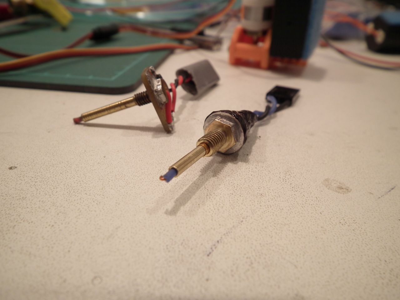

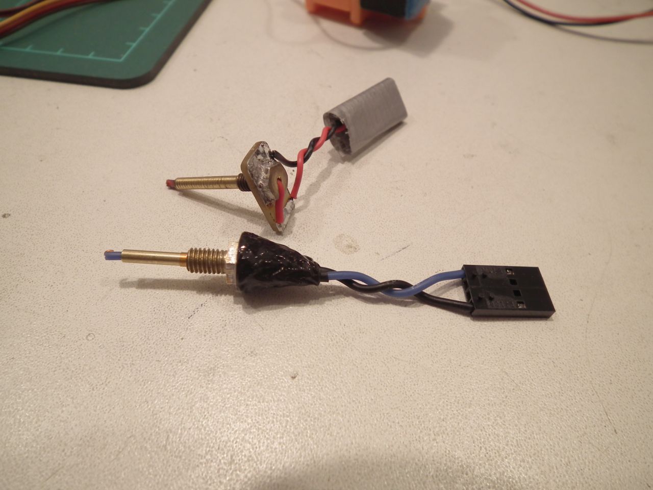

At the demo, I had troubles with my spark controller. It would often reset after the first spark.
I have later found that it is not a good idea to use the RESET pin of the microcontroller as input, as it will easily pick up noise from the spark and even though it is not enabled as reset, it will still "reset" the microcontroller (as the pin voltage spikes above VDD I guess). At least, it became much more immune to noise when I changed this.
Also these noise issues got me testing whether the spark could affect the RC system, and it certainly can, it can make servos twitch, and it can even reset the RC receiver, rendering the RC plane uncontrollable for a few seconds, possibly resulting in a crash.

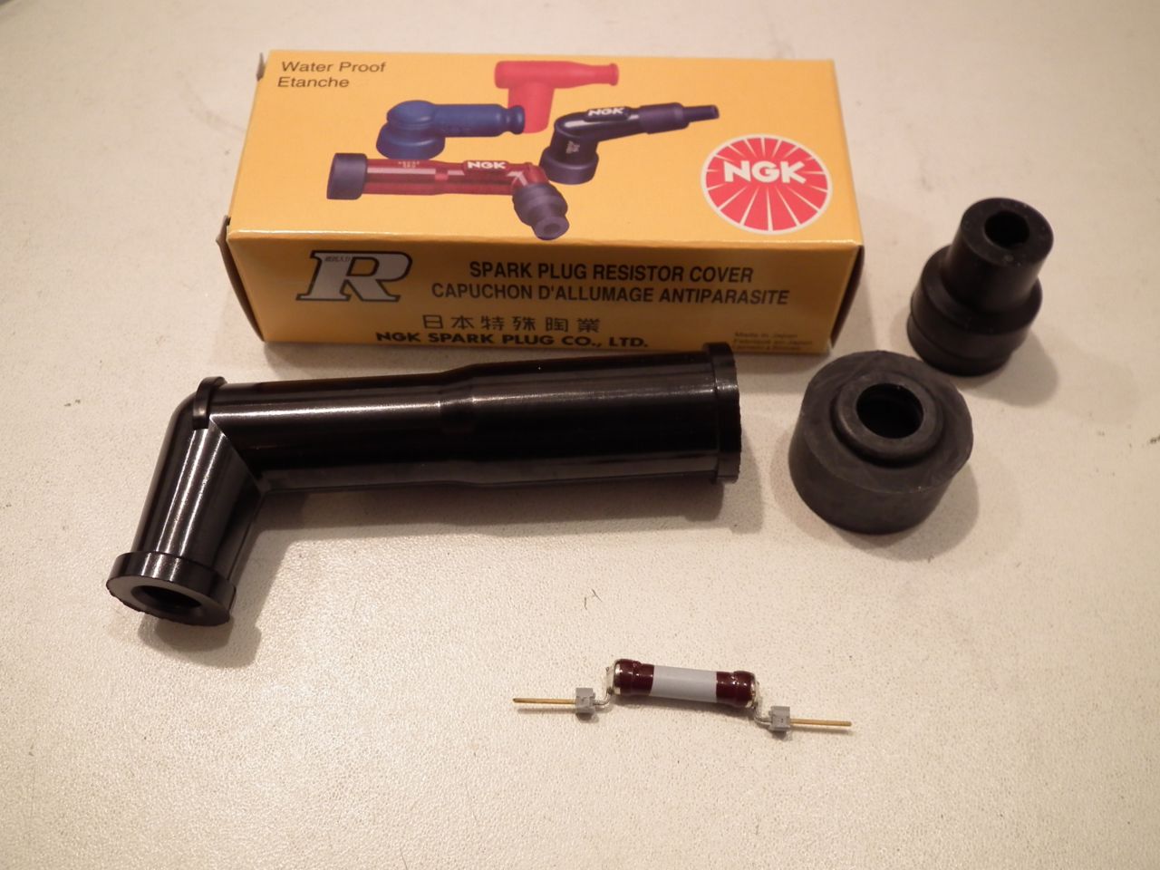

So at the RC meeting, a guy came up and gave me some hints. Along with what I found myself, I have these considerations to make:

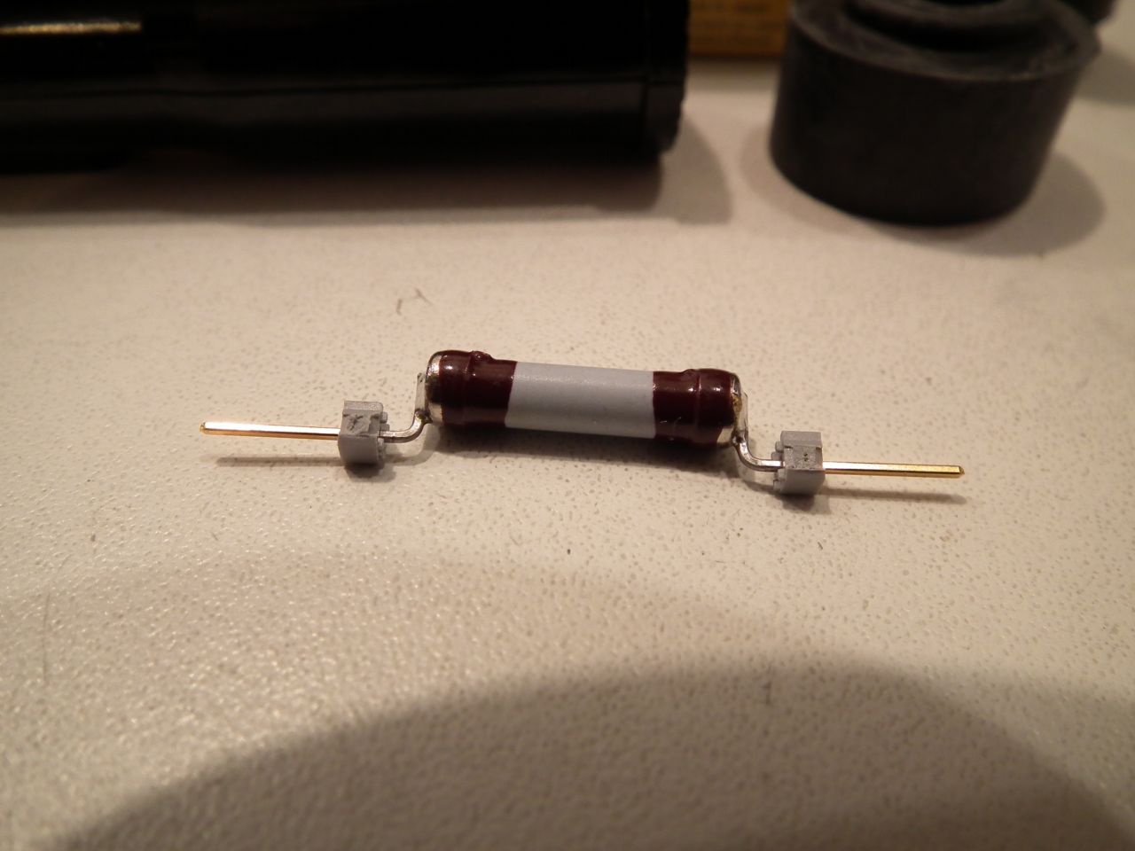

- Don't let any of the high voltage lines be electrically connected to the metal parts of the cannon. At the moment, one of the wires are in contact with the initiator chamber through the spark plug assembly. This will make the initiator chamber act as an antenna for the noise. I'll have to change this and I have a few ideas on how to do that.
- Use ferrite beads or toroids on both the power supply input and HV output of the HV module. I have ordered some samples to test.
- Use a resistor in the HV path to limit the current in the spark. This requires a high voltage resistor, and those are not easy to find and pretty expensive at the electronics stores. I knew regular spark plugs often comes with an internal resistor, exactly to reduce electric noise, and by researching this a bit, I found that you can get spark plug caps with built-in resistors. My plan was then to break open a spark plug cap and hopefully be able to salvage the resistor. So I bought 2 different types of resistor caps at the engine store, and what do you know, one of them could be disassembled using only a screwdriver and out comes the perfect little high voltage 5kΩ resistor, even with solderable tabs at each end! It did set me back around $8 US, and I'll need 1 resistor for each cannon. I'll have to see if ebay can help with cheaper resistor spark plug caps. The spark plug cap is a NGK XD05F, stock no. 8072.
