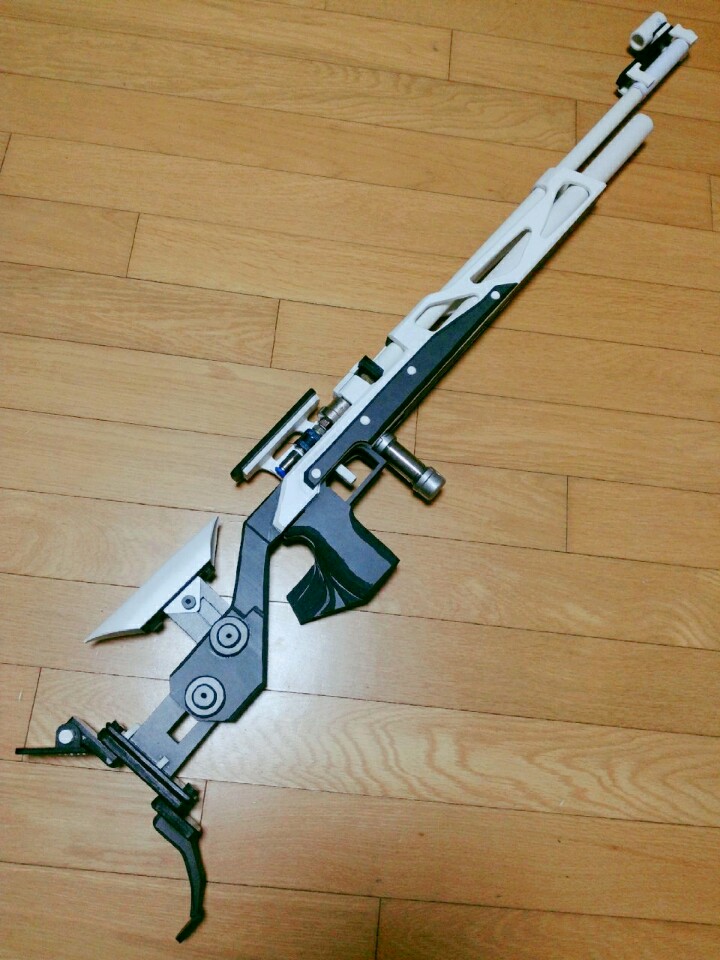

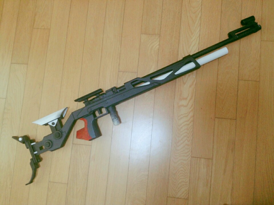

Hello! It's been a while since I posted break-action air rifle
After that post, I was worried about what gun to make again.
As a result, I was able to create an air rifle for the shooting events to commemorate the Olympics this time.
Because of the nature of the QEV unit that I use most of the time, there is a similar feeling to the Olympic Air Rifle because it is a one-shot, one-shot structure.
ammo: 6mm plastic BB (steel BBs are illegal in my country)
pressure: 100~120psi/shot (CO2 cartridge)

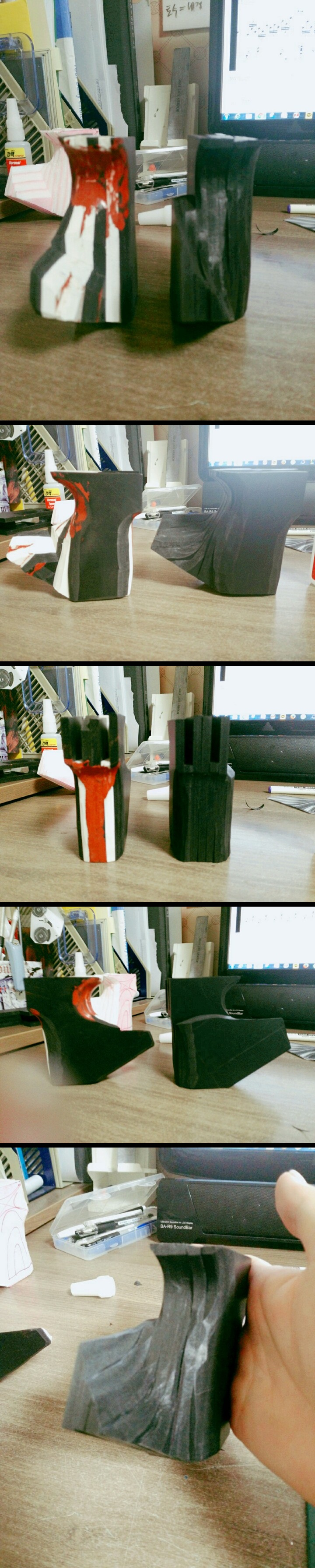

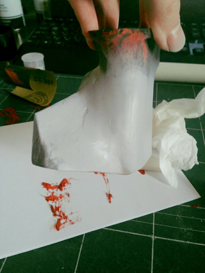

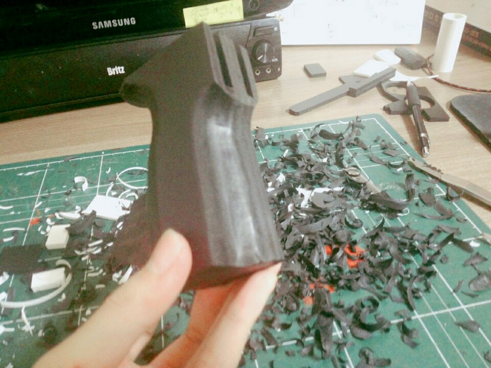

I do not have anything yet, so I have a lot of sculptures, but once I have the body, I will trim it before painting.

Wow it looks fantastic.
What size is your chamber and what pressure do you run?
Would like to use the same chamber as yours for a pistol project.
Keep up the great work! 8) 8)

Air2theBrain wrote:Wow it looks fantastic.
thnaks a lot! I use 6A QEV for this project, and previous, 8A
pressure: 100-120, 16g CO2 cartridge.
I'll look forward to your wonderful work.

If you worked for Feinwerkbau, this group size would get you fired - but since this is spudfiles and you're firing airsoft BBs, fantastic job!
