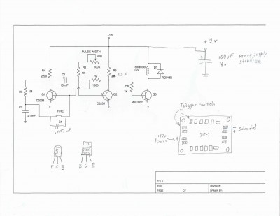

For anyone interested I attached a schematic for a variable speed trigger controller. Range is 18ms - 1200ms. Ignore the pc board diagram. That was for my benefit. A friend designed and built it for me. I'll try to answer questions, just don't get to techy.
