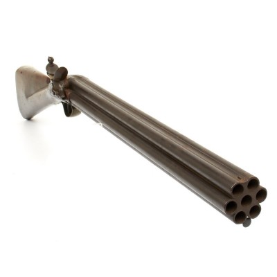

farcticox1
Posts: 1081
Has thanked: 69 times
Been thanked: 96 times
Sun Jun 24, 2018 5:13 pm
PVC Nock Gun :D

Thu Jul 12, 2018 6:17 am
Reminds me of this:
Hate to see the worky bits concealed but ah well :) great work!
