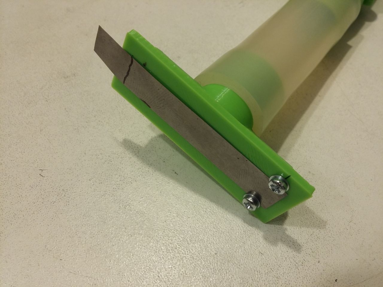

Now that I have forced air at the intake, I'm going to try to add a reed valve and see what that does to the combustion process - I hope that it will help direct most or all combustion pressure out through the main tube and barrel outlet, and not let some of the pressure out through the intake as it does now. Hopefully this will also add to the noise level
I'm using the thinnest of my feeler gauges (0.05mm) as a reed for the initial test. I can get thin stainless steel foil from ebay in even thinner sizes if 0.05mm is too stiff.

I tested my quick and dirty reed valve yesterday and it did not give any noticeable difference in sound performance. I guess the radial fan is powerful enough alone to overcome most or all of the back pressure from firing the cannon.
I also confirmed this by comparing fan temperature with and without the reed valve, the difference was minimal so the intake flames does not reach the fan much.

So I tested 2 things today: Reed valve function and minimal mixer assembly.
First I 3D printed a white tube where I fitted the propane nozzle. Plain and simple construction. See pictures.
Then I fired the sound cannon indoors (with hearing protection) and turned off the lights. Now I could clearly see how far back the flame got, and I could clearly feel the blast of hot air coming out the radial fan. I repeated the test with the reed valve in place. After this, I'm reconsidering to dump the reed valve. I'm sure the radial fan will last longer with a reed valve in place. I just need to work a bit on the design.
And the simple propane feed is working perfectly fine with the radial fan feeding the air to the sound cannon.
