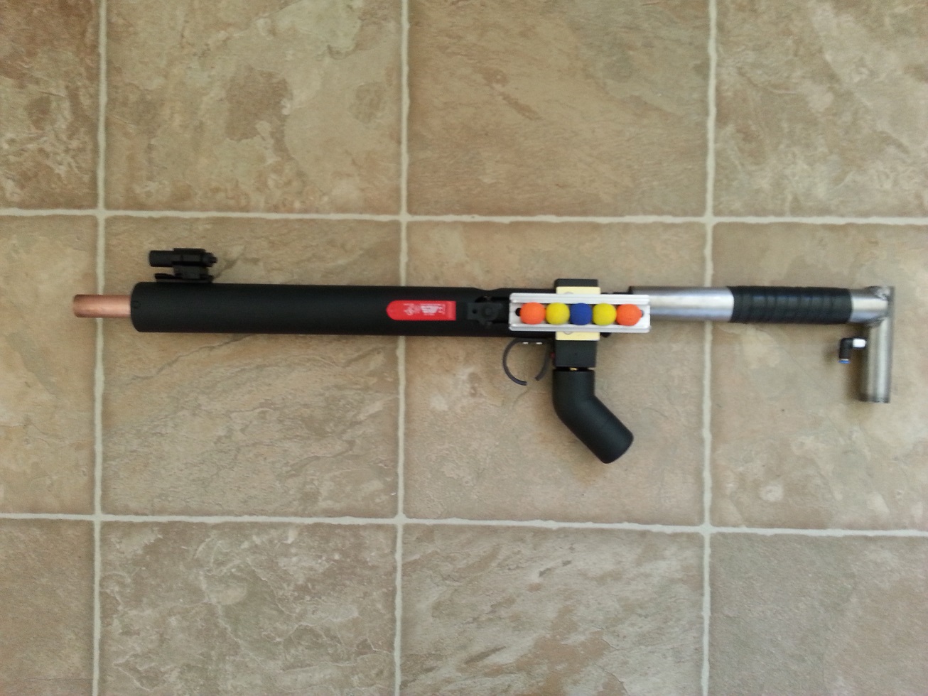

This will send Nerf Rival 200ft at 160psi, 3/8 manual trigger air valve, very simple
