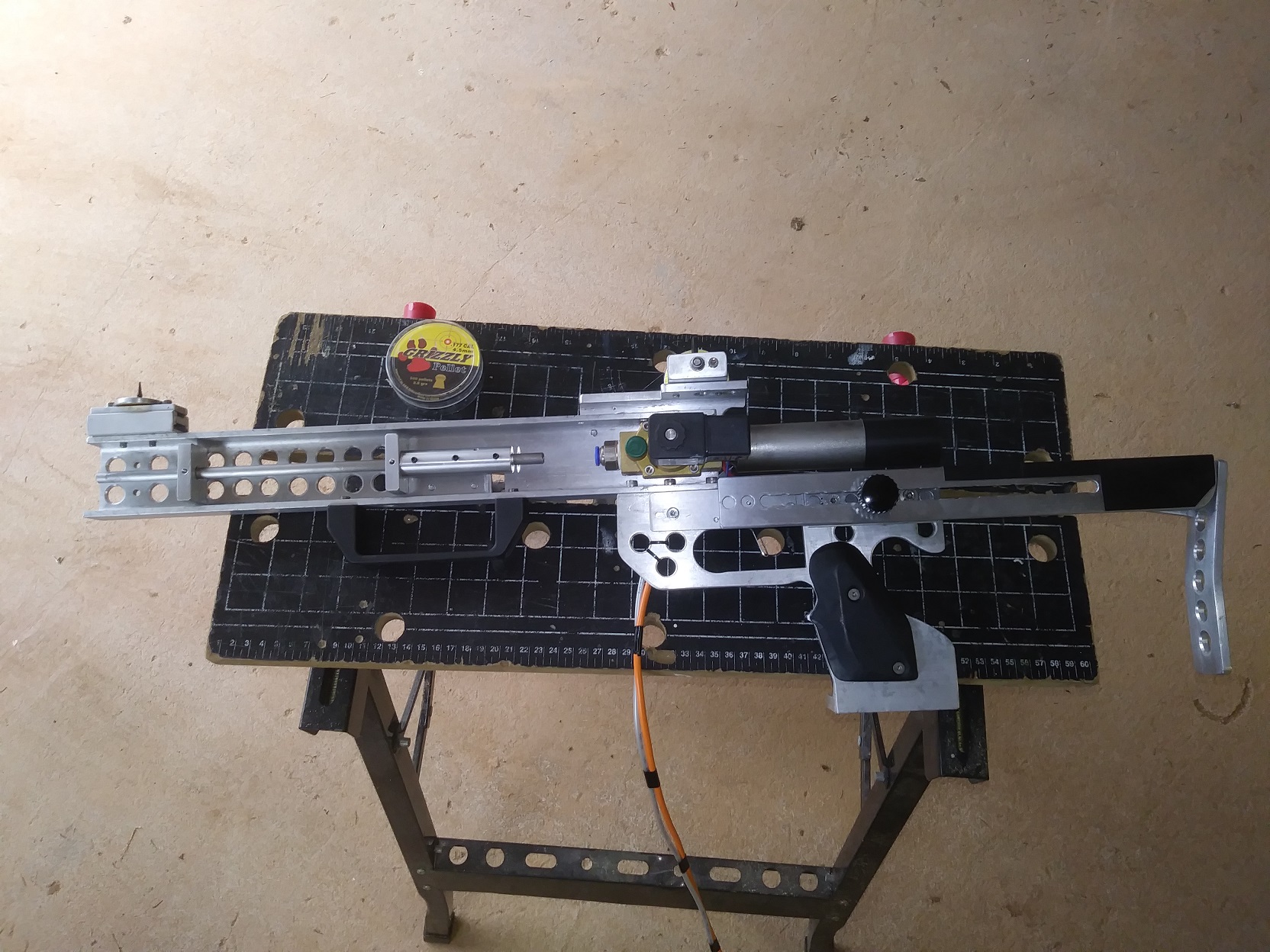

.177 smooth bore (.183" ID seam less tubing). Barrel is 750mm long and uses a 24vdc solenoid valve, chamber is 1" x 12" sch40 stainless steel charged to 150psi from my compressor. Single shot bolt action. BB's not so accurate but the dome head lead pellets are pretty good :D

150PSI is safe to use push to connect fittings and hoses, you could have routed a larger chamber inside the handguard and have multi shot capability

Nice work, I like it!
Been thanked: 350 times
Love the look! Got any chrony readings?

Not yet, I will need to make an adaptor to fit the new barrel size.

Thanks for sharing man - It's pretty sweet! Did you 3d print any parts as well?

No it's mostly aluminium & stainless chamber and barrel. It's pretty simple really.
