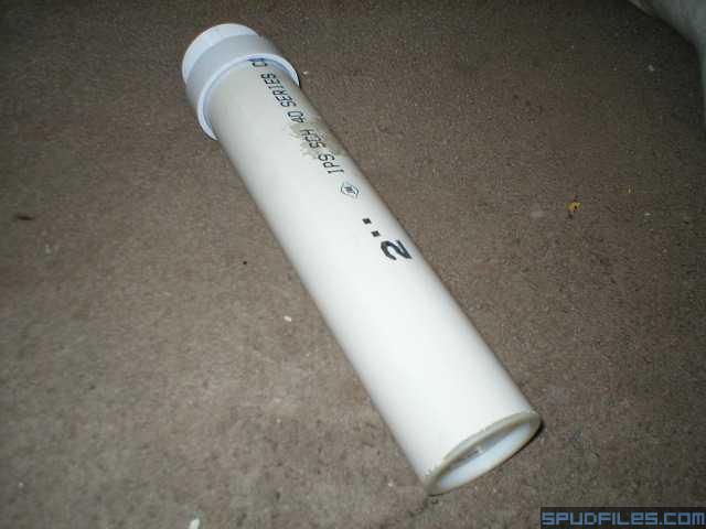

The CLAC is a very simple cannon. The CLAC was originally built and used to test a theory involving a sprinkler valve for a new gun I was planning. The purpose was to determine weather or not a sprinkler valve could handle rapid pressurization from a chamber. The cannon was built exactly as it looks now, minus the 2" female adapter on the end. The sprinkler valve was placed directly after the ball valve. Once testing was complete, I took off the sprinkler valve and ended up basically with a cannon with a 1" male adapter after the valve. So I took a piece of 1" pipe and put a female adapter on it and used that as the barrel for a while. Then I decided to make a cannon that could have 'cartridge' type things, filled with stuff that you could screw on and fire the stuff out (IE confetti). So I lopped off the male adapter and put on a 2" female adapter. I got some 2" pipe, male adapters, and knockout plugs.

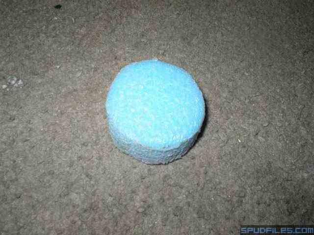

The cartridges are just 11" of 2" pipe with a male adapter on one end. The knockout plug is on the other end to hold whatever you put in until you fire the cannon. Now to completely seal the cartridge for storage or whatever, I took some foamy packaging stuff (kind of like styrofoam but with more of a plastic consistency) and cut it into a circles a kind of wadding. This is the same stuff I used to make the shoulder rest for the <a href="http://www.geocities.com/fiebigspudguns/TTAC.html">TTAC </a>. The plug was stuffed down to the bottom of the cartridge.
So now I had a fully working pneumatic cannon. The cartridges are loaded by simply pouring whatever you want in the pipe and closing it up with the knock out plug!
