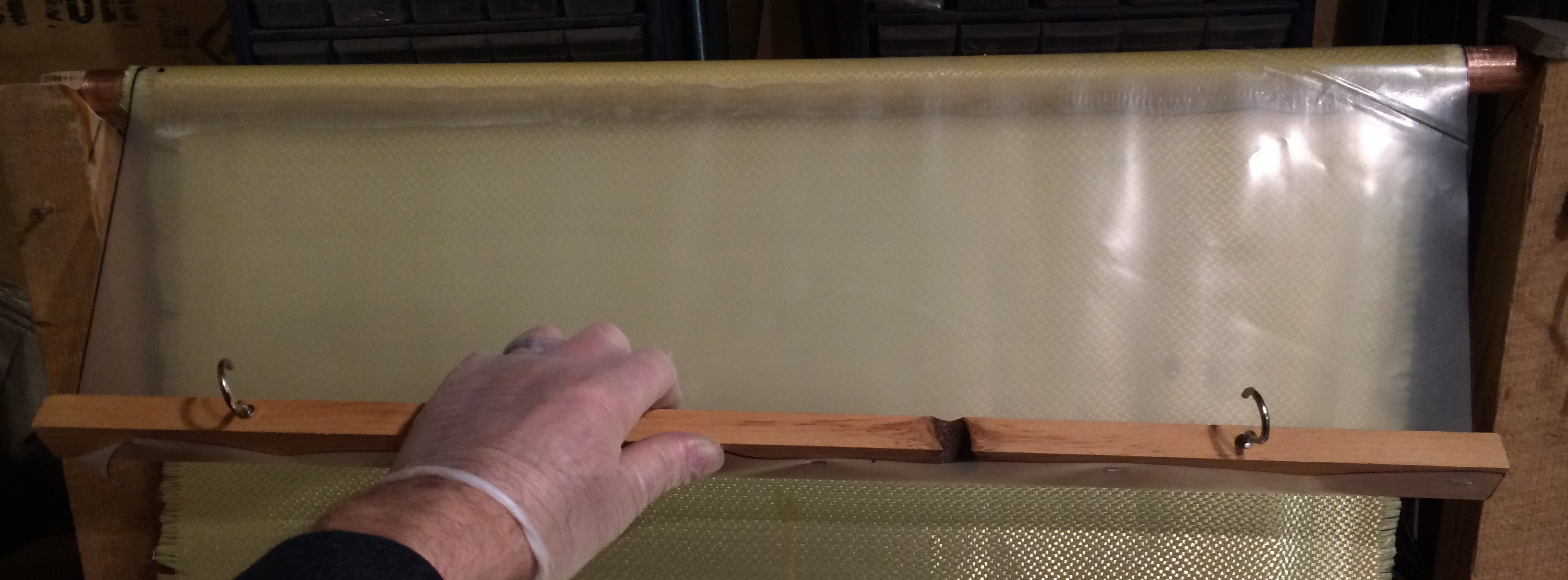

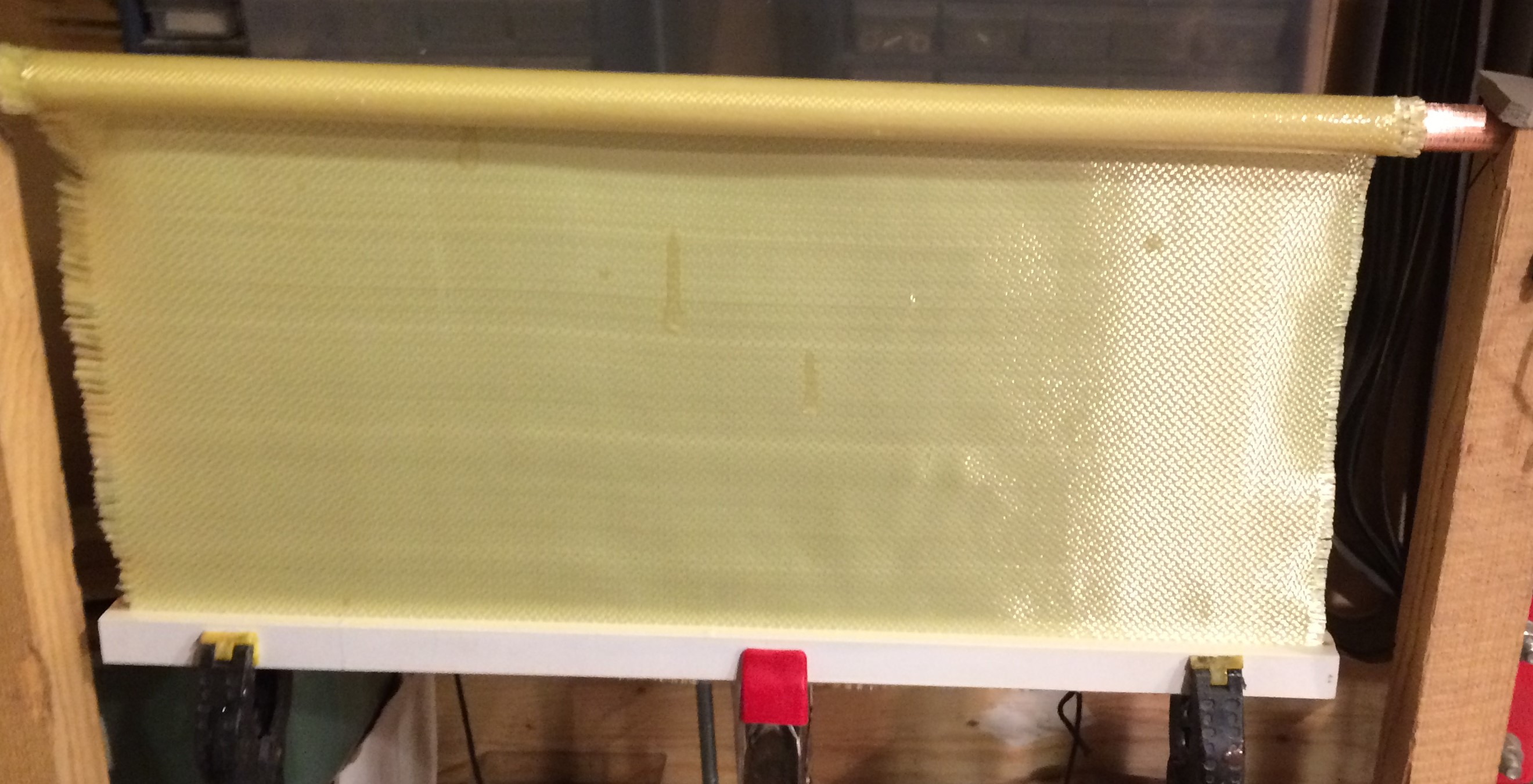

The trick was building a jig to maintain some tension on the fabric as it is being wetted with epoxy, and then to hold the seam flat while the epoxy cures. I gave up using vacuum as it was just too tricky to keep the wrinkles and blisters out on this type of lay-up.

I think that's a 3/4 copper pipe wrapped with enough Kevlar to give a burst strength of 21000 psi (not including the copper) and probably lighter than mild steel.

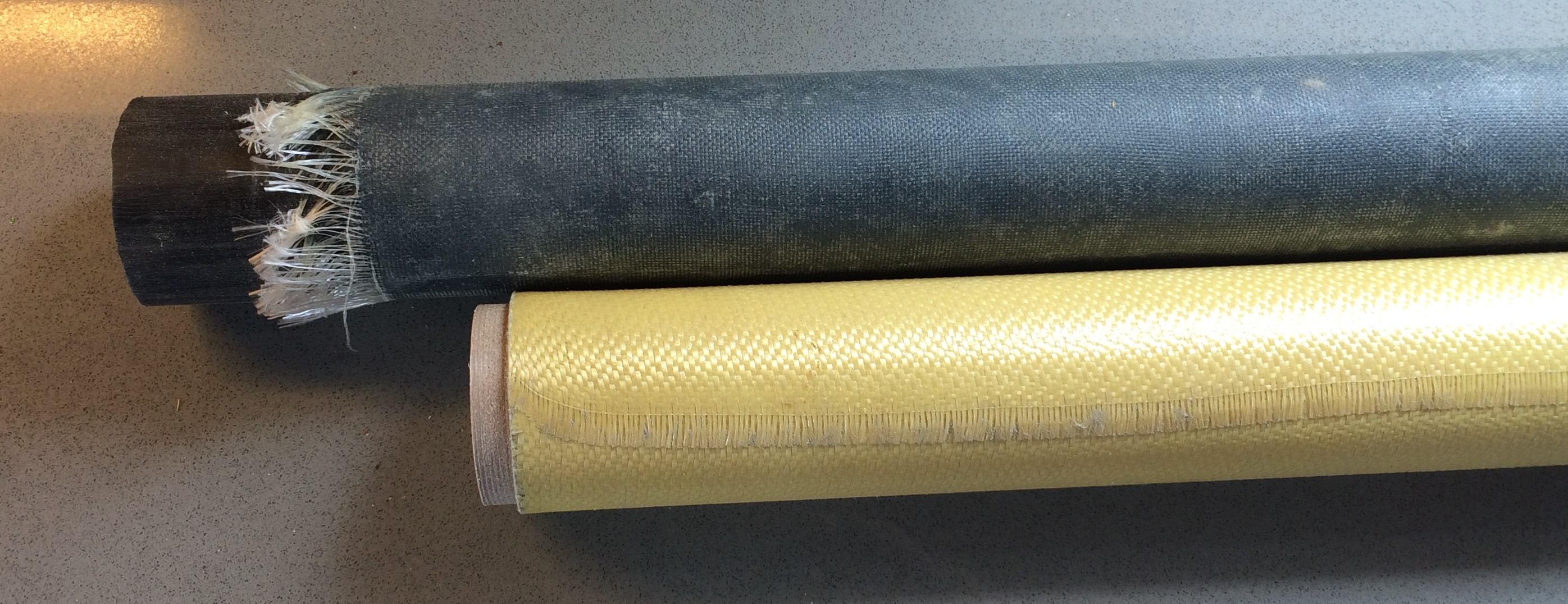

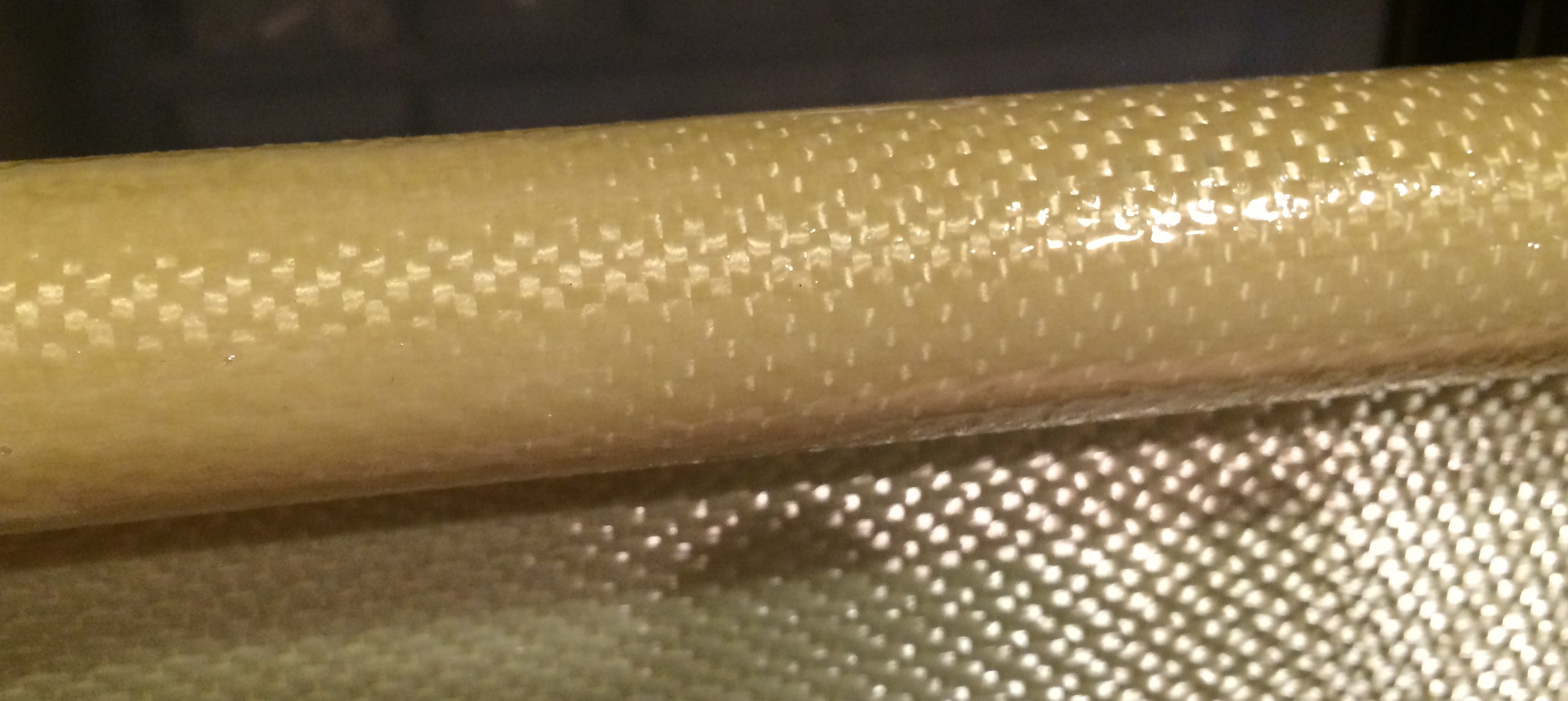

The largish Kevlar tube was my first try. It's on some very thin walled PVC (central vac tube maybe?) Note the finished edge didn't stay square but at least the fibers are all locked down. Also shown is ABS with fine glass before trimming. I can't even find the seam on that one.
