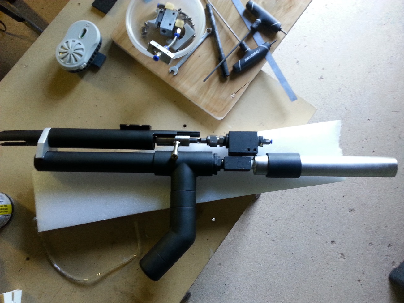

farcticox1
Canada
Posts: 1088
Has thanked: 69 times
Been thanked: 103 times
Over under like this works fine
Or chamber to the rear (front is just PVC)
I mostly use these brass fittings, they are rated at 800psi. Anything you get should have a working pressure rating.
